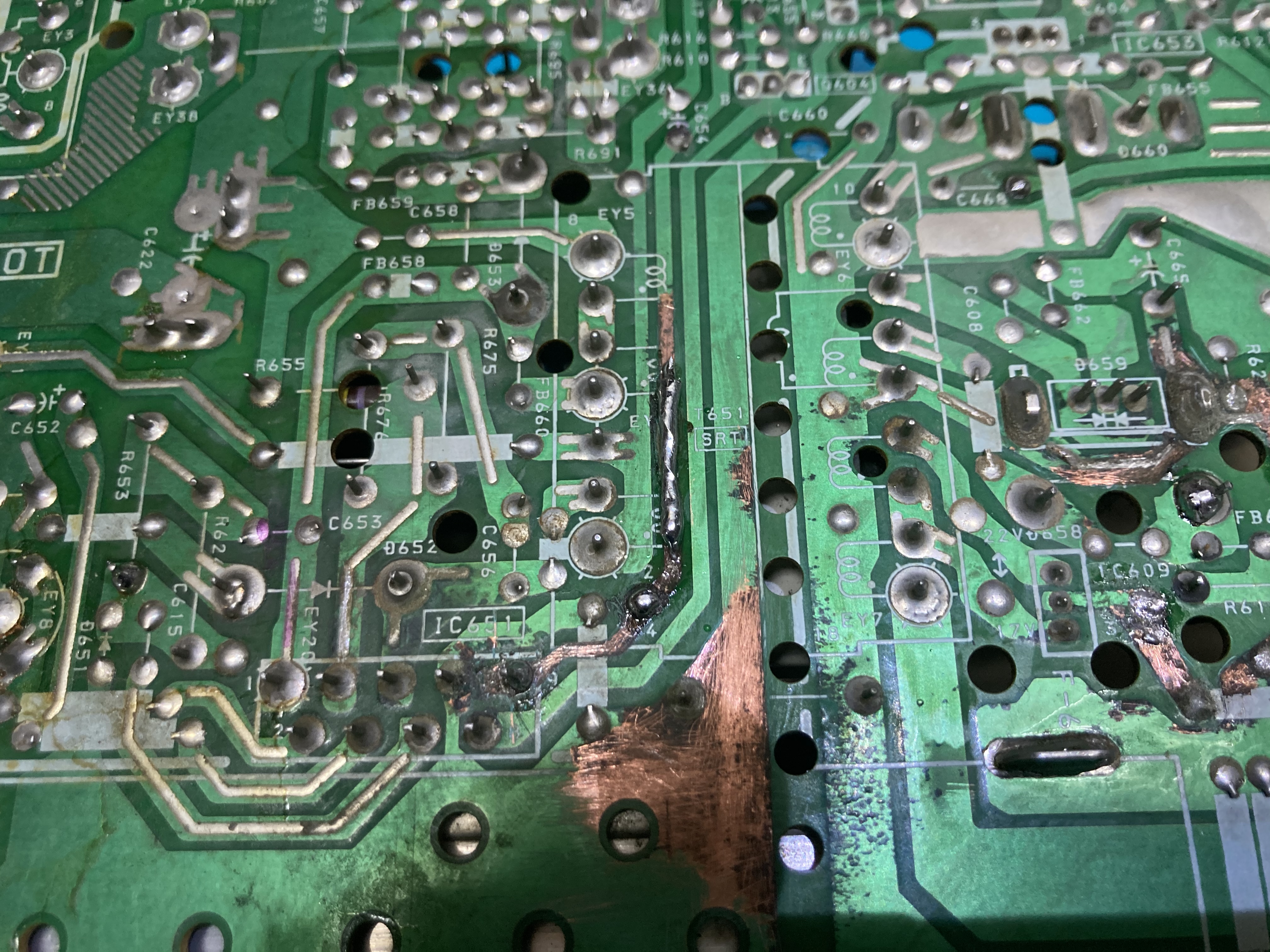

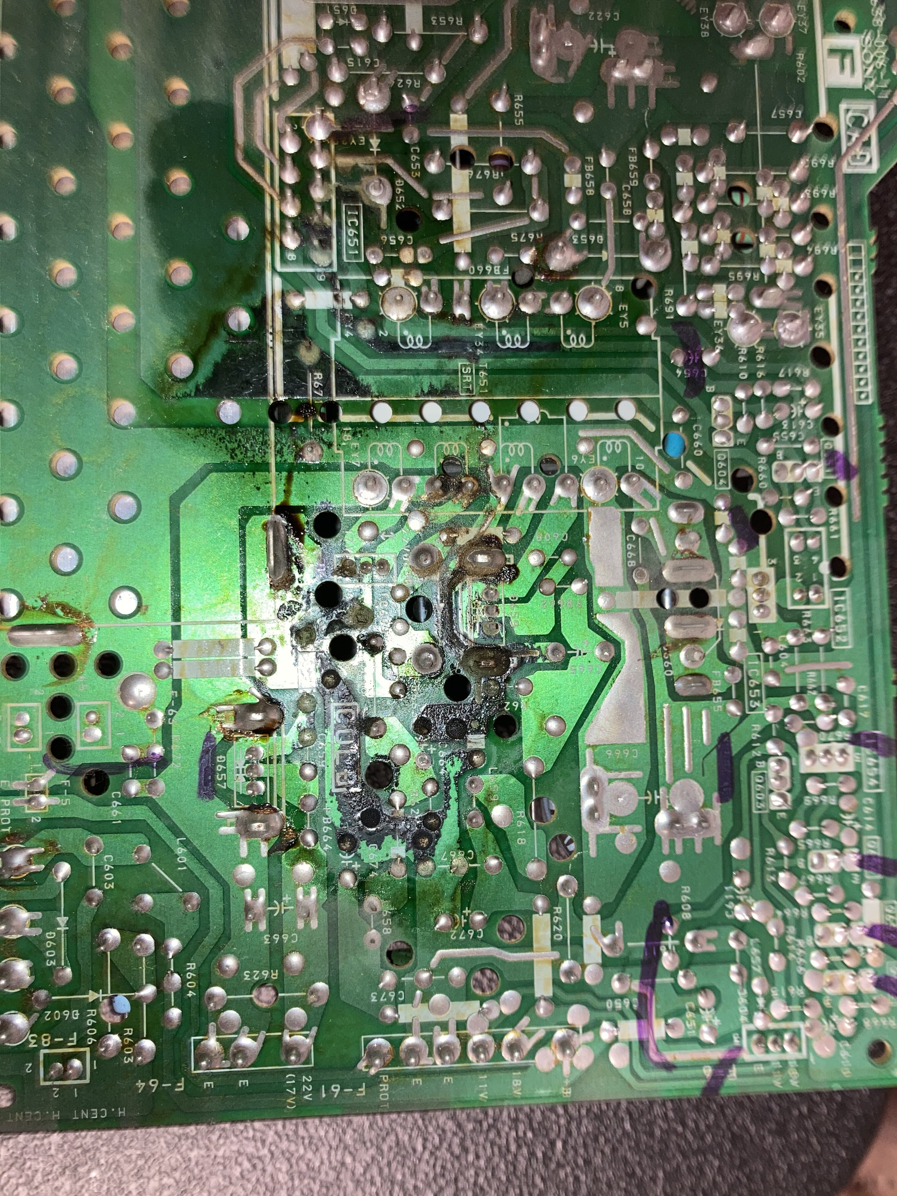

Thank you for your advices but think I found the cause. I took another look at the power board and something caught my attention. One of the screw holding the board in place look a bit crusty and greenish/oxydized compared to the other screws. I pulled out the board and it seem one of the capacitor leaked and made a mess on the underside of the power board. My plan is to clean up the cap leakage residue and brush up the blackened trace with a fiberglass pen, reseal and then replace the cap (and maybe other around while at it) and pray that it did not fry any others component around.

Clean it up, replace the cap, and see what happens - what was the number of the failed capacitor?.
That’s reassuring, thanks for checking it out for me. I’m a bit more hopeful that I’ll get it back in working order. I’m still cleaning up the leak’s damage but its all big sturdy traces, so it could have been worse. I’ll reflow a few oxydized solder joints and pins, try to replace the cap that are easily accessible and will try it out after!
I finally cleaned most of the damage and replaced the C664 capacitor, but alas, no luck. Pretty bummed out as the tube sounded like it was firing up longer but I'm still not getting any pictures. I can hear the tube slightly crackling similar to wood burning in a bonfire but nothing else. If I press power again, you can hear the tube trying to fire again like before and nothing more. Its a bit disappointing, I really thought this would do the trick:(

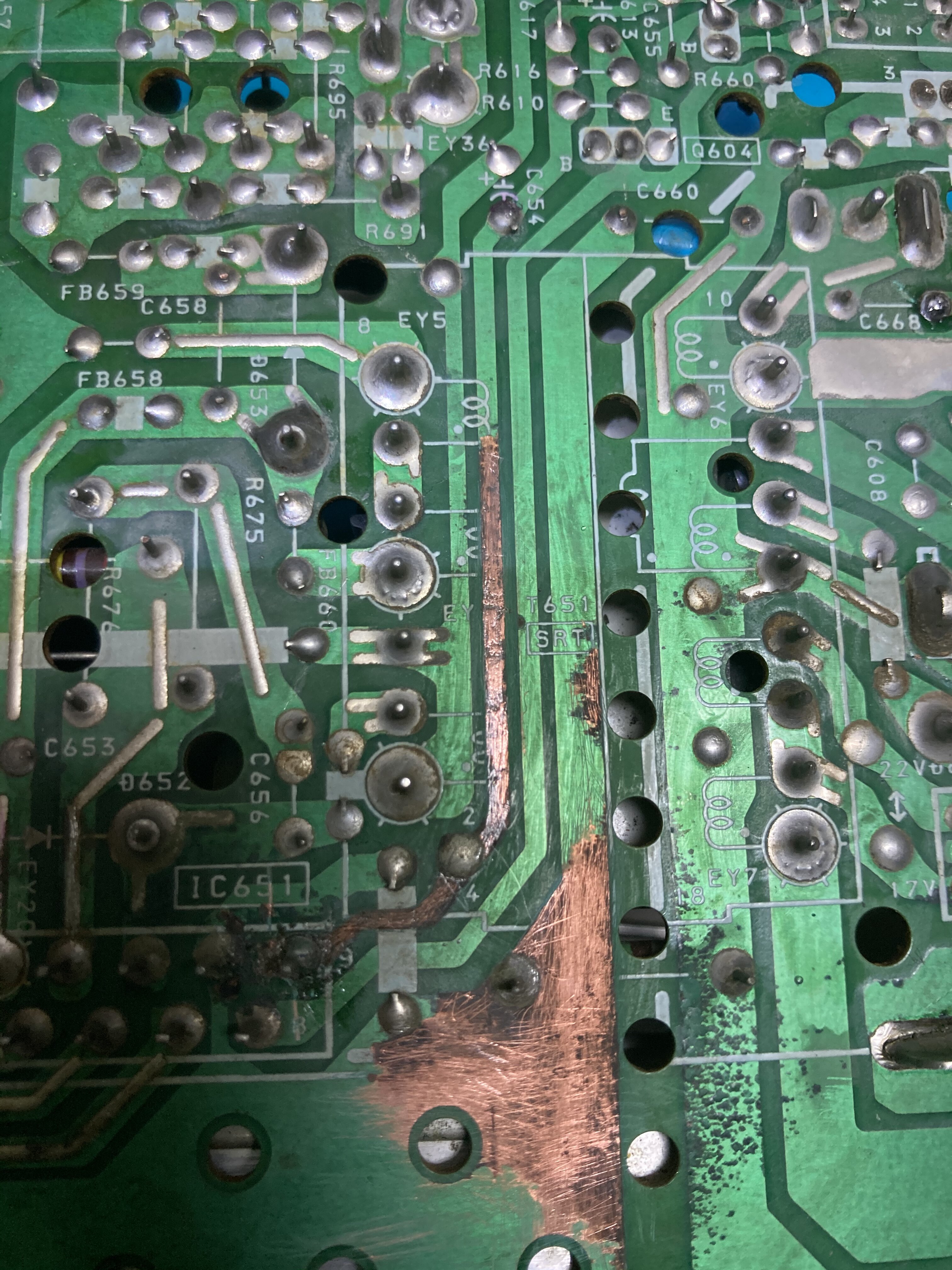

I managed to fix it! I went back to the basic and started checking all the traces and solder joints I had cleaned and was surprised to find out that a fairly big trace that looked ok had a micro break in the middle. Soldered a jumper wire and all is back to normal! Thanks everyone for your help!
