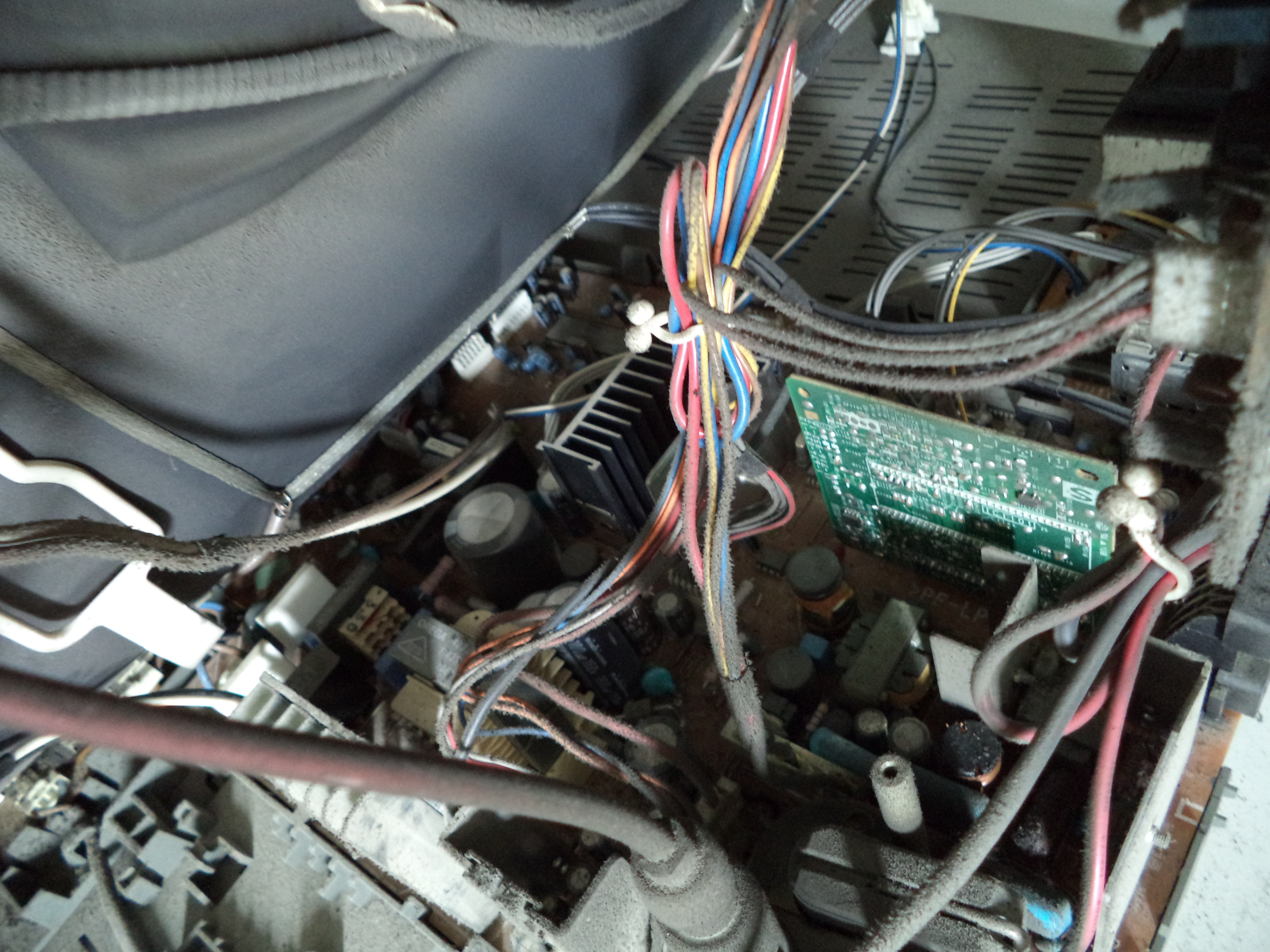

I have a Sony CRT KV-29FX20K I try to repair. It worked perfectly fine before, however it started to change the picture into green hue for a long time. Sometimes it changed colors but changing it to green was probably the most common one. After that the picture started shutting off completely and the LED blinked 5 times. Sometimes the picture reappeared and disappeared and the LED blinks 5 times whenever the picture is off. Now it almost never works. I need to wait 20-30 minutes and the picture sometimes appears but disappears after a few seconds. The LED still blinks 5 times
I tried replacing the RGB transistors as suggested in other threads but unfortunately it didn't fix the issue. Symptoms are identical. Well, at least I didn't make it worse. I read somewhere this could be a power issue and this TV probably needs a full power supply recap. However, when I unscrewed the TV, there is no sign of leakage or bulging anywhere. There is nothing suspiciously obvious inside, just kinda dirty
What could be the issue here? How likely is the recap going to solve the issue?
