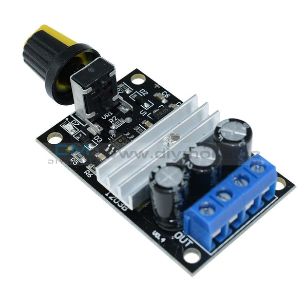

Thanks @Diver3000. Would you reckon one of these would do the trick?
That would reduce the current, but what you probably need is something to allow it to speed up gradually. The device you linked to has just a knob to control the speed, and if you are wanting it to turn on an off, you either need a power supply that is powerful enough to let it start, or something that limits the current when the motor is turning slowly and then increases speed.
Would this be more appropriate?
Are you wanting to have the pump turn on and off automatically.
If not, either controller could be fine. Just turn on with the control knob set to the minimum, and turn it slowly up to the maximum. That should allow the pump to start with just about no turn-on surge, but very gradual starting.

Thanks to quick shipping from Amazon, I was able to test out the PWM controller today. Worked like a charm!
Power bank PD port to PD Trigger set at 12V to PWM motor speed controller (6-24V, 3A) to my bilge pump. Picture attached. The extra on/off switch is handy and can crank the pump from 0 to 100.
