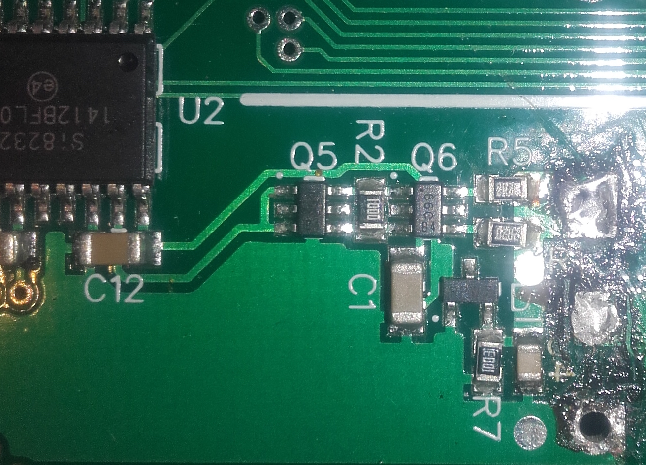

hi, I'm trying to determine why the 4 mosfets in a solar diverter (diverts excess solar to immersion rather that exporting to grid) have failed. the 4 mosfets are used to PWM the 230v a.c.
the components I'm trying to ID are two 6pin SOT23(?) devices Q5 & Q6 in the pic, between the isolated output gate driver (si2328d) and the gate of the mosfet. They're labelled 66C and B4 (at 90 degrees from each other) and I've drawn a blank trying to ID them.
there's also the 3leg component labelled D4 which has RPW 3d on it - I'm guessing that it's some sort of diode?
the isolated gate drive psu is shorted by something - either the above devices or the si2328d (i've removed the fets).
Any help with these smd components would be greatly appreciated - it's difficult to test or order replacements if i don't know what they are.

I'm thinking the RPW 3d is a dual zenner diode - although i may have to test a working one to determine the voltage.
Still foxed by the 66c b4 device though - guessing it's some sort of transistor/dual transistor / driver. the two middle pins appear to be vcc and gnd
Aha! that does look plausible.
Thank you.
The closest I found by looking through SMD lists was a dual fet, but both were n-channel.
Trouble is I'm pushing the boundaries of my understanding of gate drive ccts: the main si8232* driver chip is good for 4a which i would have supposed was perfectly good for driving the big fets - So i don't understand what these little dual fet devices are there for.
I'm wondering if they are the ones you found or just similar - if i replaced some of them with a similar (but not identical) device is it likely to muck up timing to the point of shoot through or other failure mode?
following your lead I've looked up dual fet n + p and found this one (DMG6602SVTQ) which according to the data sheet would be marked 66C and the B4 would indicate a manufacturing date of april 2014 - plausible. :)
https://www.farnell.com/datasheets/2814392.pdf
Only issue now is there seem to be variations on this device with different letters after the 6602 - is it likely to matter which variation i use?
That does look like the exact device!
