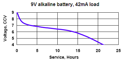

For your project that is powered by a little 9V battery, you need a low-dropout regulator that continues to work as the battery voltage drops over its life. You don't need 1A output with its high operating current. You don't need a wide 1/2V tolerance. You don't need the big case.
The voltage of a little 9 alkaline battery quickly drops to 7.2V then drops slower to 6V over its life. See my graph.
The LM2931AZ 5.0 is guaranteed to have an output from 4.81V to 5.19V that is regulated, when its input voltage is only 6V. Typically it operates well when its input voltage is only about 5.3V. Its max output current is limited to 100mA. It has a low operating current. It is in a small TO-92 case like a BC547 or 2N3904 small transistor. It is perfect for circuits powered by a 9V battery and all semiconductor manufacturers make low-dropout 5V regulators like this.
