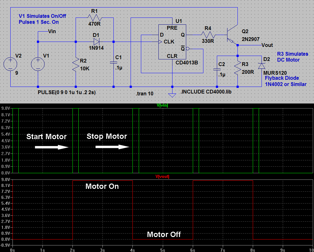

could someone kindly post a drawing of a circuit as Reloadron has suggested as I have no experience of flipflop

Here is something that will work:
The circuit looks more complicated than it really is. As drawn V2 is the 9 volt power. V1 was only used to simulate the reed switch, the actual normally open magnetic reed switch is shown in the lower image. Where you see Vout in the lower image that would be connected to R1, R2 nd D1 junction. R1, R2, D1 and C1 make up the switch debounce circuit and drives the 4013 D flip flop. The Q output of the 4013 drives the Q1 transistor which drives the motor. The 2N2907 is a very common off the shelf transistor capable of driving a 800 mA load and your motor likely draws less than that. Passing a magnet over the reed switch will start the motor and passing a magnet over the switch again will stop the motor. C2 is there to clean up any brush noise from the motor and D2 acts as a flyback diode across the motor. The CD4013 is a dual flip flop chip. Here is the data sheet. A Google of flip flop 4013 circuits will bring up dozens of similar circuits.
This is how I would likely go about what you want to do. There are other ways and methods.
Hope this helps....
Ron
Shouldn't the transistor be a NPN type?
I guess it could be a 2N2222 and move the load up to the collector side. I figured it would work either way. Actually Alec, never gave it much thought but a better design likely would be a 2N2222 with the motor, flyback diode and the filter cap on the collector side. Still not sure what the OP wants but figured I would toss something out I figured would work. Don't even really know the motor current and I guessed just a little 9 volt hobby motor.
