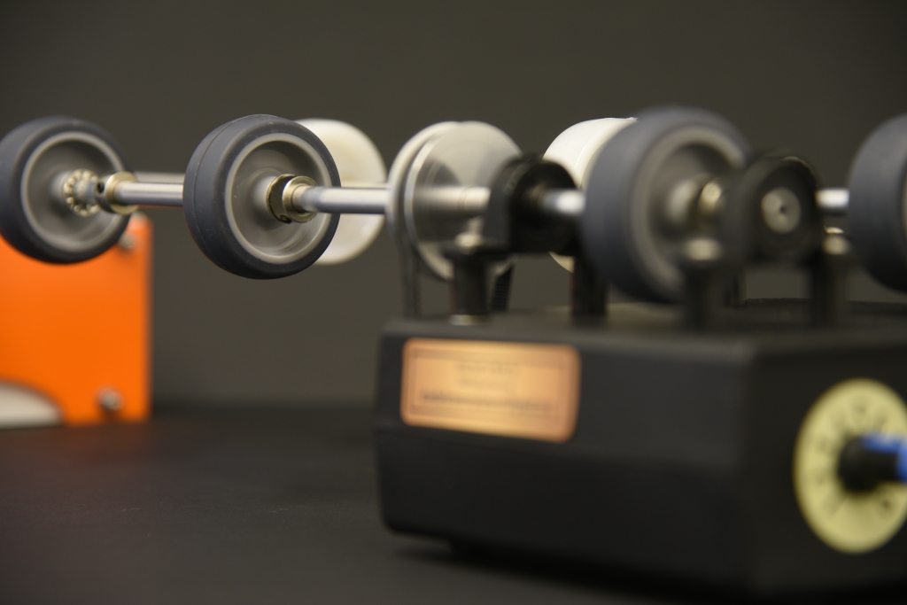

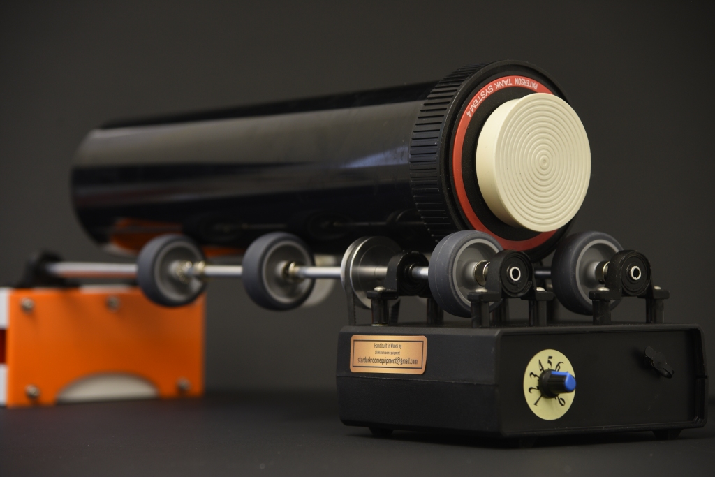

He and I started a small company selling darkroom equipment.
One of the items we designed is a rotary film processor variable speed that is affordable to all, please see images.
I have a question and hope that someone may help, please
I can and have only found 5mm bore pulley systems (see video), with 8mm for the rods which are perfect but as you will know we now have a problem, see video.
The motors are 4mm on the shaft the pulley is 5mm bore. I have drilled an tapped an extra screw :(
ANY advice much appreciated
Video here
Thank you

An alternative approach would be to get motors with 5mm shafts. How are you controlling the speed - it looks to be adjustable.

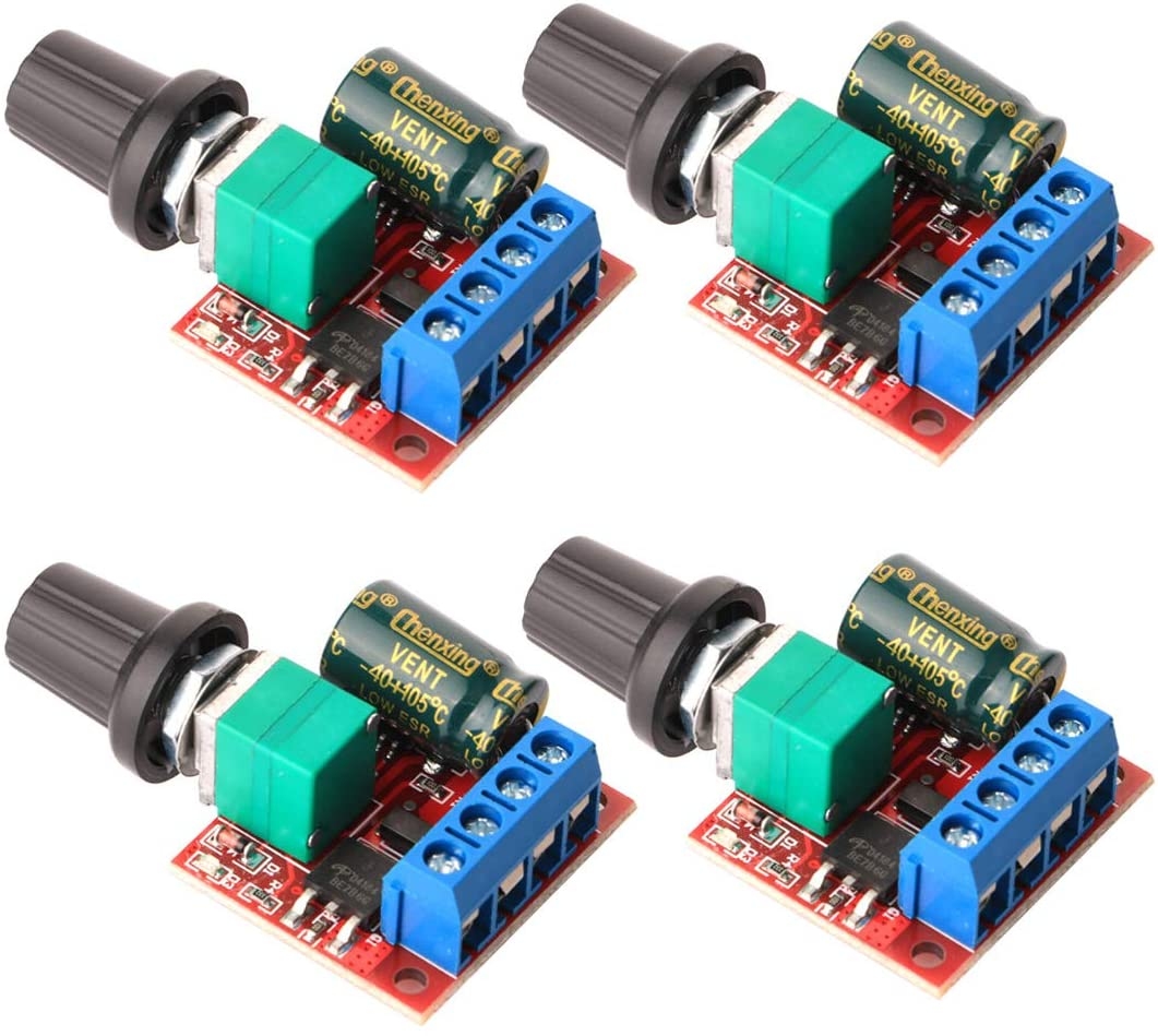

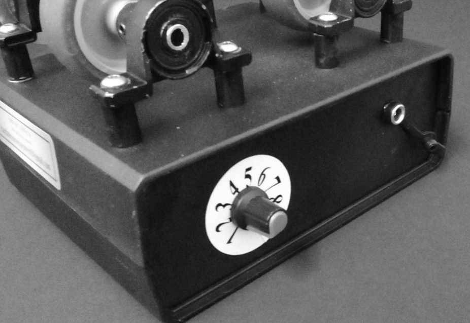

I have some NEMA17 stepper motors that have a 5mm output shaft. I noticed the control and if you're already using a micro to read the potentiometer and control the motor then to switch to a stepper would be a reasonable step - hence question 2. Another picture of the dial doesn't really help.

The steppers will probably cost ~US$10. You'll need a driver too. I'll ask again, how do you control the speed?
Edit, with a dial doesn't help. How electronically?
