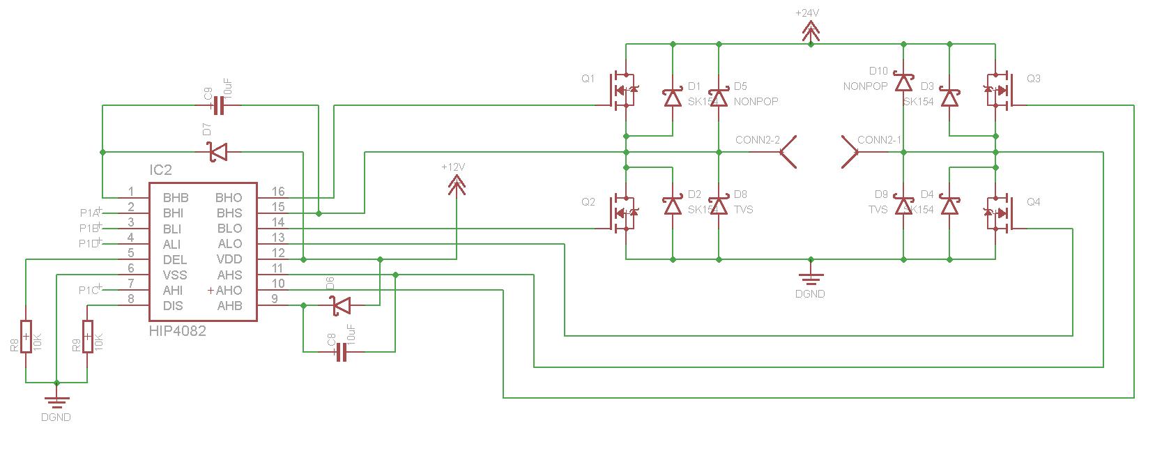

I am working with an 18F4550 and a HIP4082 full bridge driver. I'm decent with PIC's and I have all four PWM outputs working (have probed with scope).
I cannot seem to get the high side gate drive signals working properly coming out of the HIP4082. The low side signals are very good in either direction, but the high sides look like garbage. I would try to describe them to you but I'm not sure what I'm looking at on the scope really. I think my problem is likely with the bootstrap but I've tried multiple diodes and caps to no avail. I've attached my schematic. Have tried Shottky bootstrap diodes as well as regular S1B diodes and 10, 100, and 1000uF caps for the bootstrap sections. Also multiple frequencies from low <10khz to above 100khz.
If someone could look over my schematic and the data sheet for the HIP4082 to see if I did something stupid, I would really appreciate it. Thanks!

Additional info: All FET's are N-Channel 40V 50A 11mOhm Rds(on). TVS diodes are 24V operating 1.5KW peak dissipation. Schottky's are SK154 15A 40V (very nice). Using positive polarity on all outputs from the PIC. Logic level inputs to the HIP4082 (5V). Please ask if there is anything else you want or need to know, I'm really trying to figure out why my high side gate signals suck.

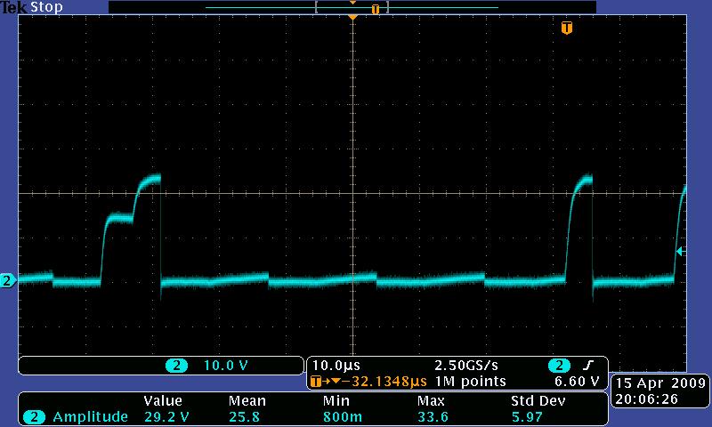

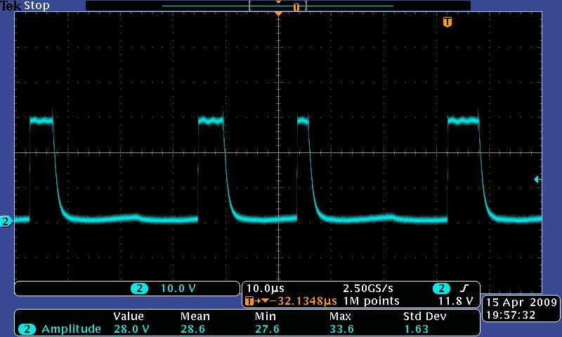

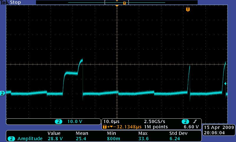

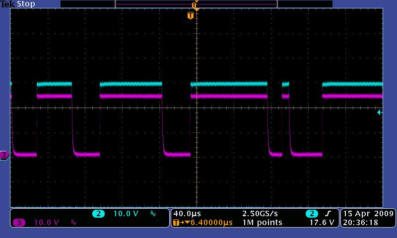

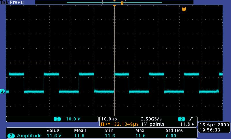

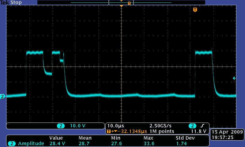

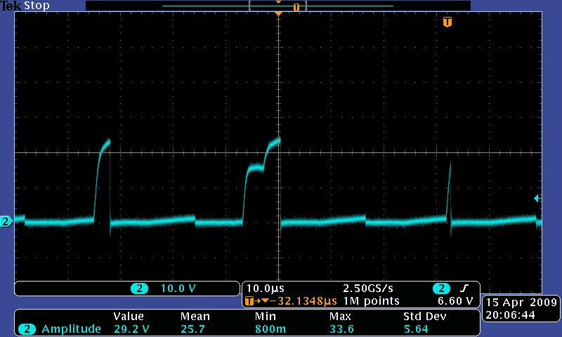

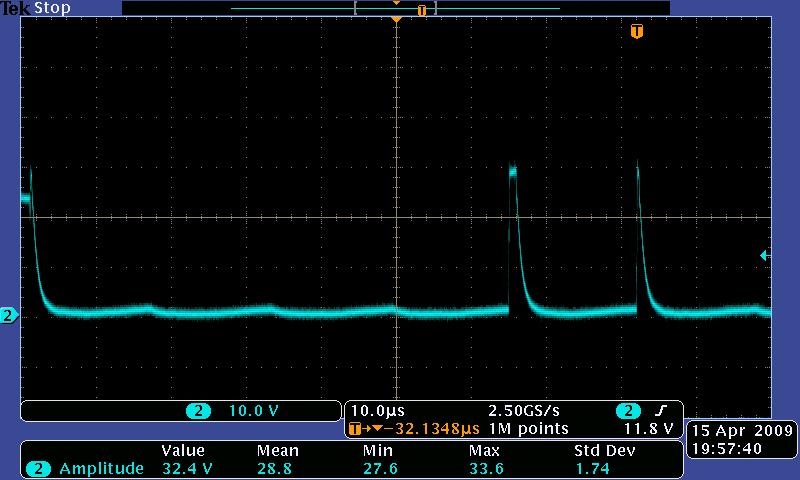

Here are four single-shots of the signals. First is the low-side gate drive signal (lower left in the schematic). The next three are single-shots of the high-side (top right) with a 100uF cap and a Schottky on the bootstrap.

Also, the other high side driver (top left in schematic) is getting a gate signal like this. It only has a 10uF bootstrap on it (I am playing around with values).

Also what ground are you using for checking the high side gates? You should be grounding the scope at the mosfets source, not the common ground.
OK, will do. The shots above are all referenced to board ground.
Yea, using the common ground will make your high side signals look all kinds of funky, as the signals are also going through the low-side circuitry before getting to ground. The low-side circuitry is causing the strange view of the high-side signals.

Nono, don't want gate drive and source voltage speakerguy.
You need to take the gate reading from the high side fets with a ground refrence from the source, you can't use the system ground for a high side fet. All FET gate voltage readings should ALWAYS be takeing from the source as a ground refrence, because that's how they operate, they could care less what the rest of the circuit is at.

10-100uF on the bootstrap seems rather high. I vaguely remember using 100nF capacitors for the bootstrap and it all working fine.
Update - looking at some of my old datasheets the bootstrap capacitor seems to be specced for 100nF to 220nF.

The last image I posted is of the gate referenced to ground, and the source referenced to ground. So the difference between the two is the Vgs for the high side FET, I just didn't put the scope into math mode and do a difference signal.

Found what I was looking for ...
On the demo board text it says ....
Consistent with good design practice, the +12V bias supply
is bypassed by capacitors C6 and C5 (at the IC terminals
directly). Capacitor C6 is a 4.7mF tantalum, designed to
bypass the whole PCB, whereas C5 is a 0.22mF, designed to
bypass the HIP4081A. The bootstrap capacitors, C3 and C4,
and the high voltage bus bypass capacitors are 0.1mF, 100V
ceramic. Ceramic is used here because of the low
inductance required of these capacitors in the application.
So they are using 0.1uF capacitors on their demo boards. Might be worth a look. This is for the HIP4080/4081 but the principle is the same.

The "ground" on the high side FETs is not the same as the common ground. It's the source output pin of the FETs themselves. Put the scope probe on the gate pin, and the scope ground connection on the source pin. That will show you a proper gate signal.
I tried that, but then my power supply started whining. I guess it is not as isolated as it is supposed to be? (scope is grounded). I got better results with the two probe method. I might as well shell out the cash for a differential probe I guess.
Also I tried with 0.1uF caps, and it didn't work at all. No high side gate signals at all, dead flat. Maybe my schottky's are too leaky?
