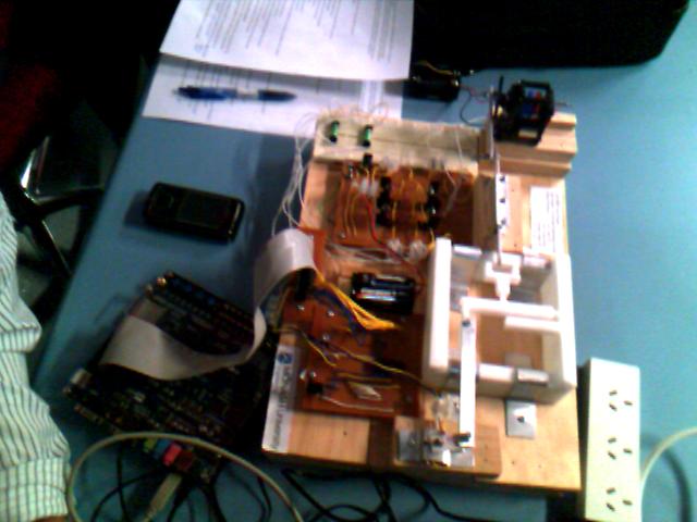

im done with my project. demoed it yesterday. thanks alot for helping me with the ADC. here's a pic. cheers
