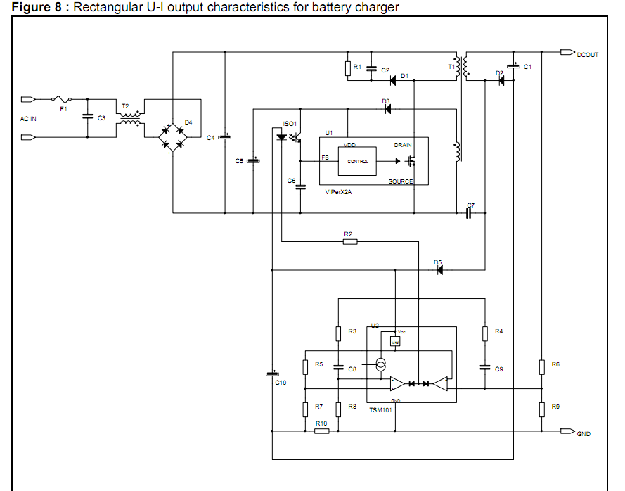

Help me understand this transformer hook up, please
kinarfi
The transformer seems to be hooked up differently from what I would expect, is it correct? It appears that the phasing dots are boosting each other, or are they bucking, or does it have to do with current limiting,
Thank You,
Kinarfi

It's not a transformer, it's a common-mode choke to reduce common-mode noise. Thus common-mode signals see the inductance of the choke since they are in-phase. Normal-mode signals (the input current) are out-of phase and thus do not see the inductance (it acts like a transformer with equal primary and secondary currents).
Also be aware that this charger runs off the 120AC Line with no isolation. Be sure to keep one hand in your pocket while you are working on it... :D

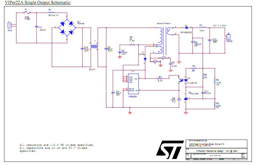

When I started this thread, I was curious about the way the transformer was hooked up, the schematic came from **broken link removed** and here's the full schematic that I started with and another one,too.

Brownout, I'm not talking about a dead short from mains to the human body model, looks like Mike said C4, I said if it was 12nF I was referring to C7, my mistake in notation as I mistook his mention of C4 as to the only cap I was concerned about which is C7. It's a moot point as there's no value for anything in the schematic, and I'm beginning to think it may be in the schematic because it was meant to be simulated and simulations can't have floating grounds.

The second schematic shows a ground at the bottom even though that circuit is part of the live line side of things.
The first schematic seems to be conceptually in order though. I think C7 could be considered an optional component but I have seen quite a few SMPS with a small snubber capacitor between the primary and secondary circuits just the same.
I suspect the purpose of C7 is just to provide a path for switching noise to the "cleanest" return path in the circuit. The ground symbols in the 2nd diagram are simply to denote a common potential, and you can think it it as those nodes just being tied together.

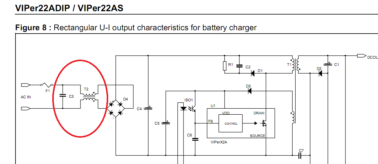

Glad to have cleared a few thing up, I hope. Another question about transformer phasing dots, as the current flows from the dot to the other end in the primary, the current in secondary flow from the dot to the other end also, correct? How much of a phase shift is there?
Also with an input of 120 vac the voltage across C4 is 170, correct?
Wait. What transformer are you talking about? I thought we decided the input component was a line filter??? If you mean that one, think of it this way; the current flows into the dot on one side, and then out of the dot on the other side. It doesn't matter which side we are talking about when we say "into" and "out of" Basically, the filter is symetrical, so it works both ways.
