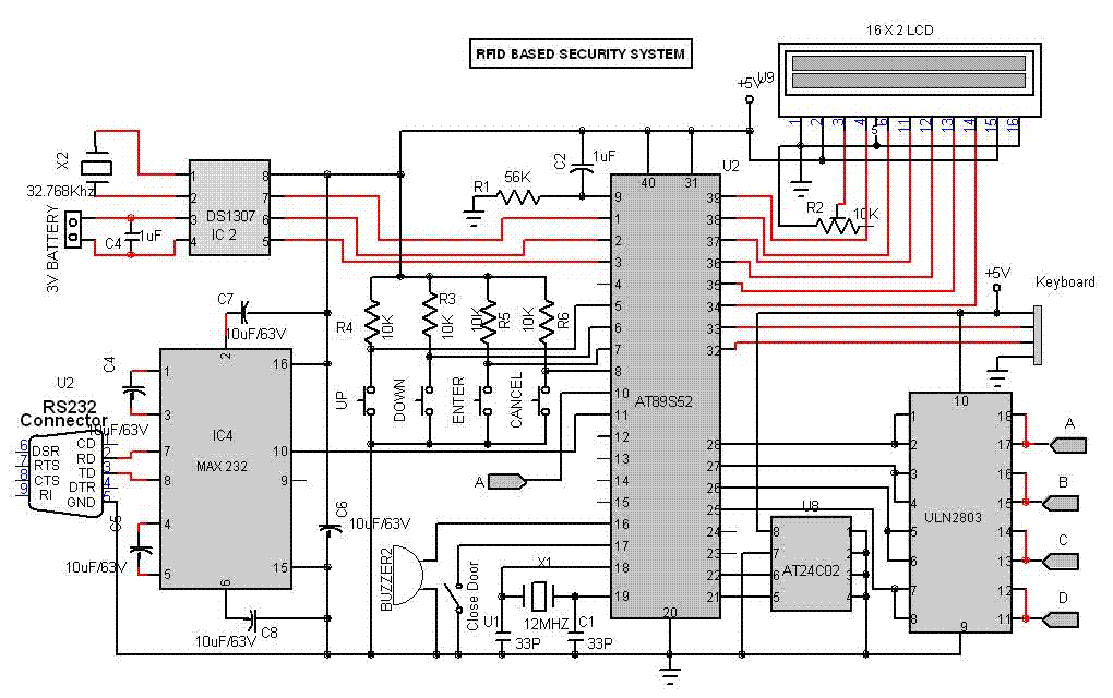

I am doing a project based on this micro - controller. and am not getting the pins 21-33......where an EEPROM is connected with a keyboard.
plaese help me out.
