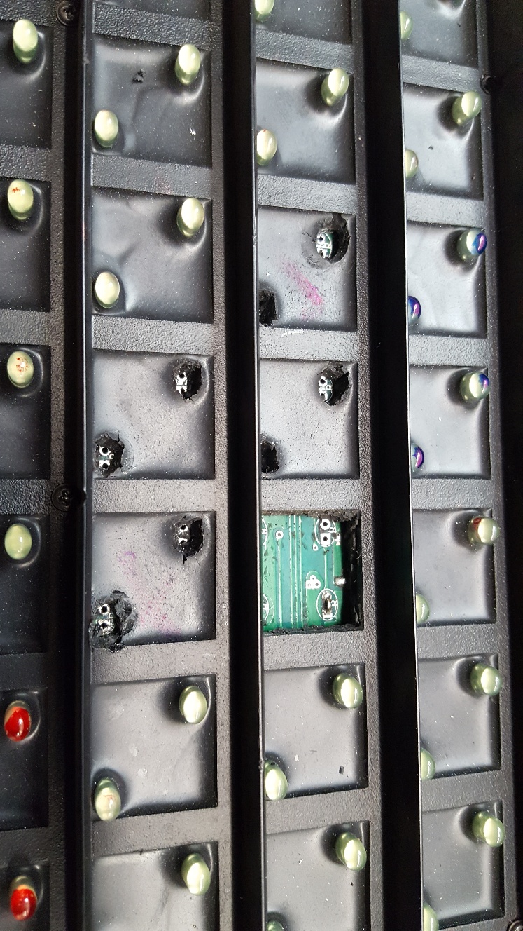

Wondering if anyone can help me identify a suitable filler to match the black material surrounding these leds.
It has a spongy consistency … you can press your thumbnail right through it easily … far softer than normal silicon.
I cut a section out and it is really easy to tear up, it has no real strength at all.
I assume its role is to weatherproof the leds, keep them aligned and provide a consistent matt background to minimise reflection.
The panel is from a sign … over 3000 leds … and ~120 need replacing. It is behind an outer perspex screen so weatherproofing is not quite as serious.
Thanks for any help.

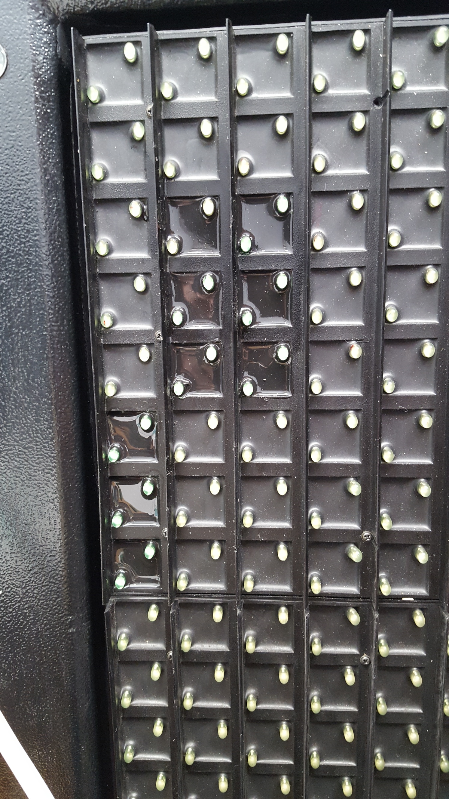

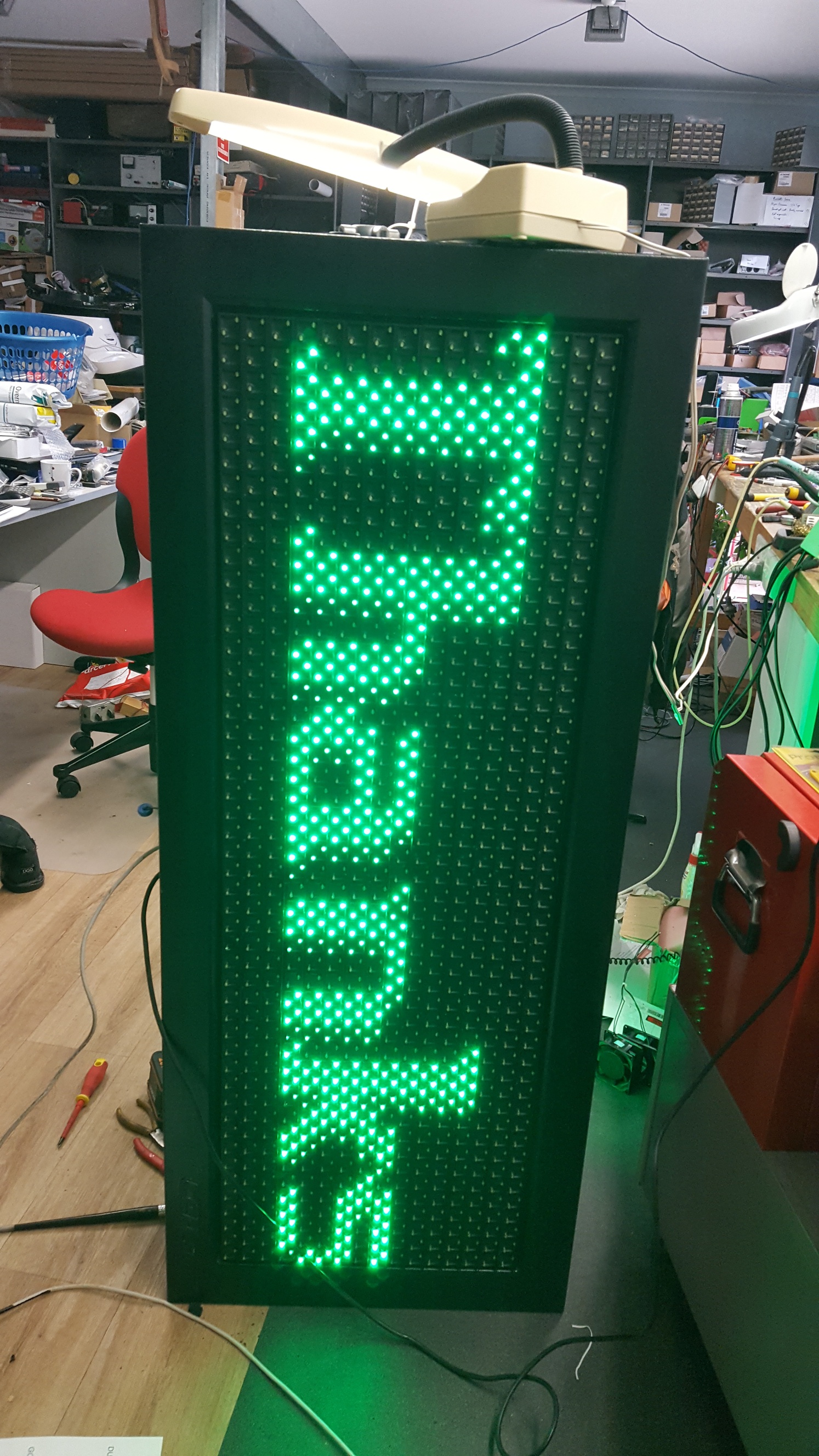

Time for an update.
The silicone turned up on time and is a real pleasure to work with. Got to be careful with the caulking gun as it will run out of the tube ... but the self leveling is excellent ... looks really good with no effort.
It's a bit shinier than the old stuff ... whether that's because it's a different product ... or coz the other stuff has been out in the elements for 10 years. Either way ... far far easier than trying to scrape in and smooth regular silicone ... and more than a few feet away you can't tell anyway. Plus once the leds are on, you need sunglasses to avoid the glare.
Looks like any spillage is best cleaned up after it has set ... just scrape it away.
Thanks BobW for directing me to a suitable product ... and you other guys for your help as well.
