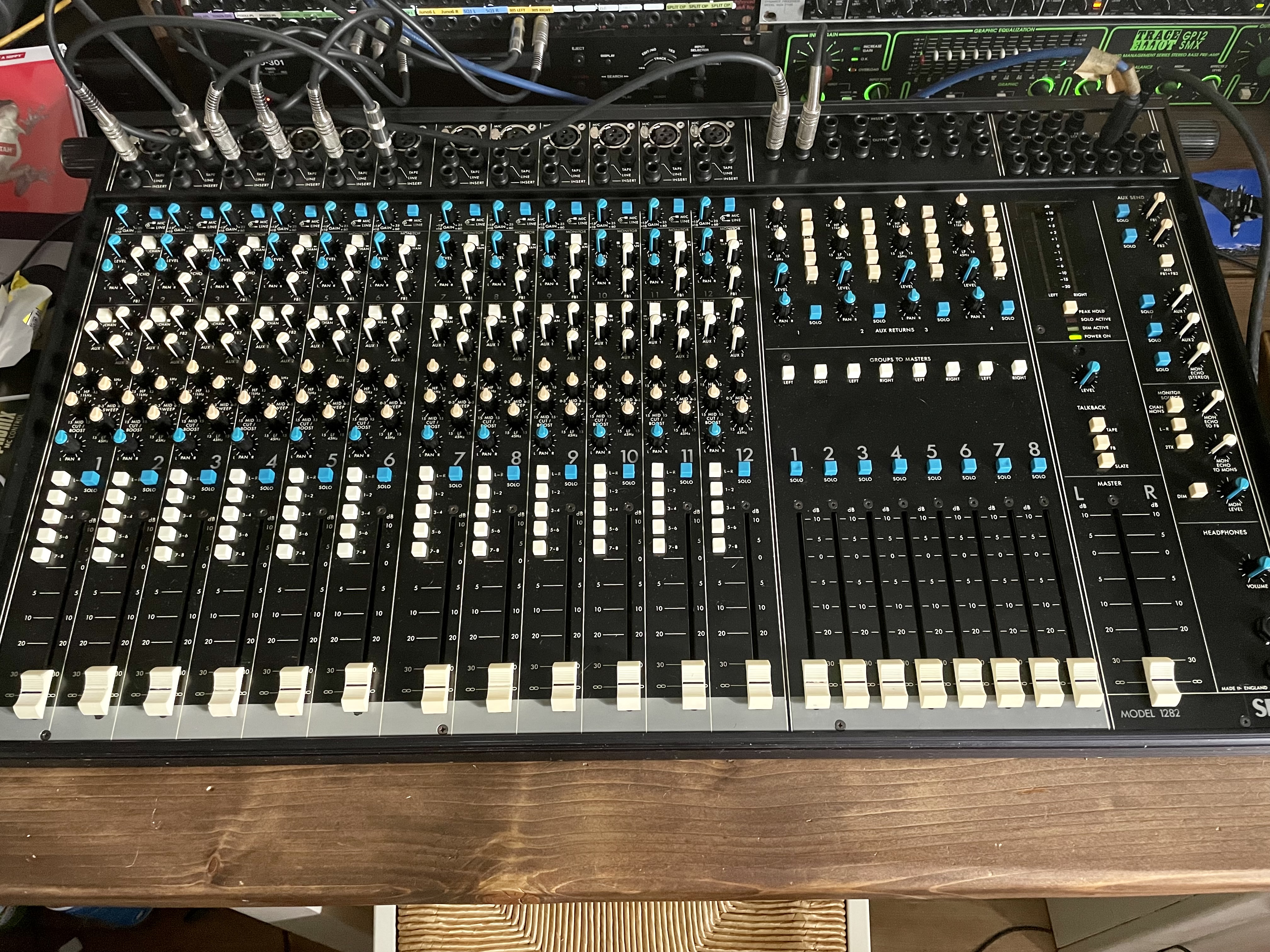

So I’ve taken the mixer apart.. there are three boards, each connected to each other with ribbon cables. There are 2 identical boards with six input channels and the third board is the 8 groups and master section that takes the power in. I’ll get some photos up once I’m up and about…
There’s one tantalum capacitors on the back of the two input boards.. and a load of radial electrolytics throughout as well.. I’ve made a list of all the capacitors on those boards, tantalum/electrolytic/ceramic and the little rectangular polyester ones..

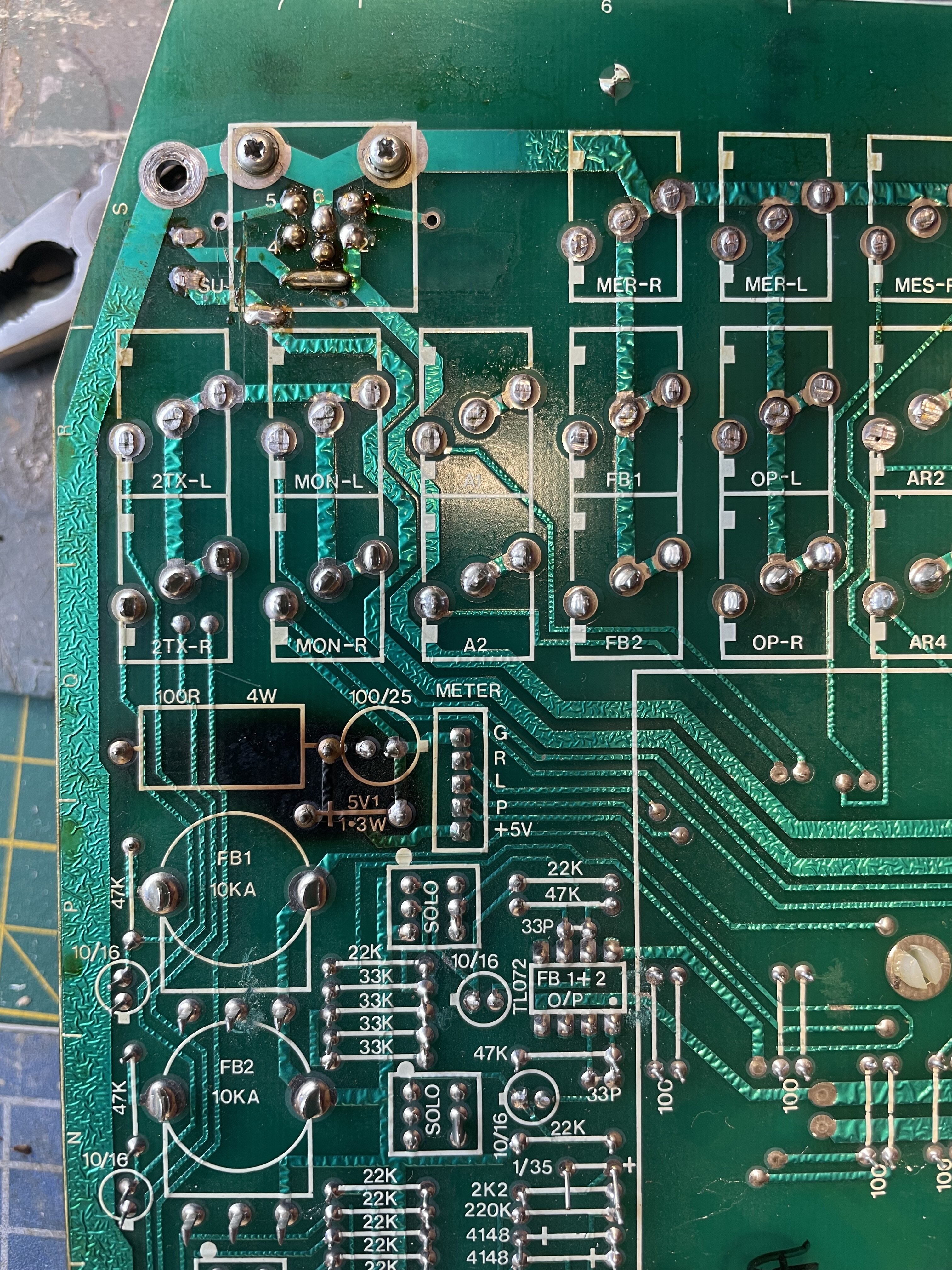

I haven’t properly logged the master board as yet but I did notice the pcb track from the power input appears to have been damaged, or so it seems… I’ll get a close up pic of that out also… if that is the cause then that would be easier than capacitor replacement I guess, as there’s lots of those and not loads of room…
Funny though, this mixer was effectively given to me about 15 years ago, working, and after the psu problem, I’m scratching my head as to how the board got scratched like that..
I guess the first thing would be to test the main board and see if it behaves in the way I saw in the beginning, and add the other boards one by one if not…?

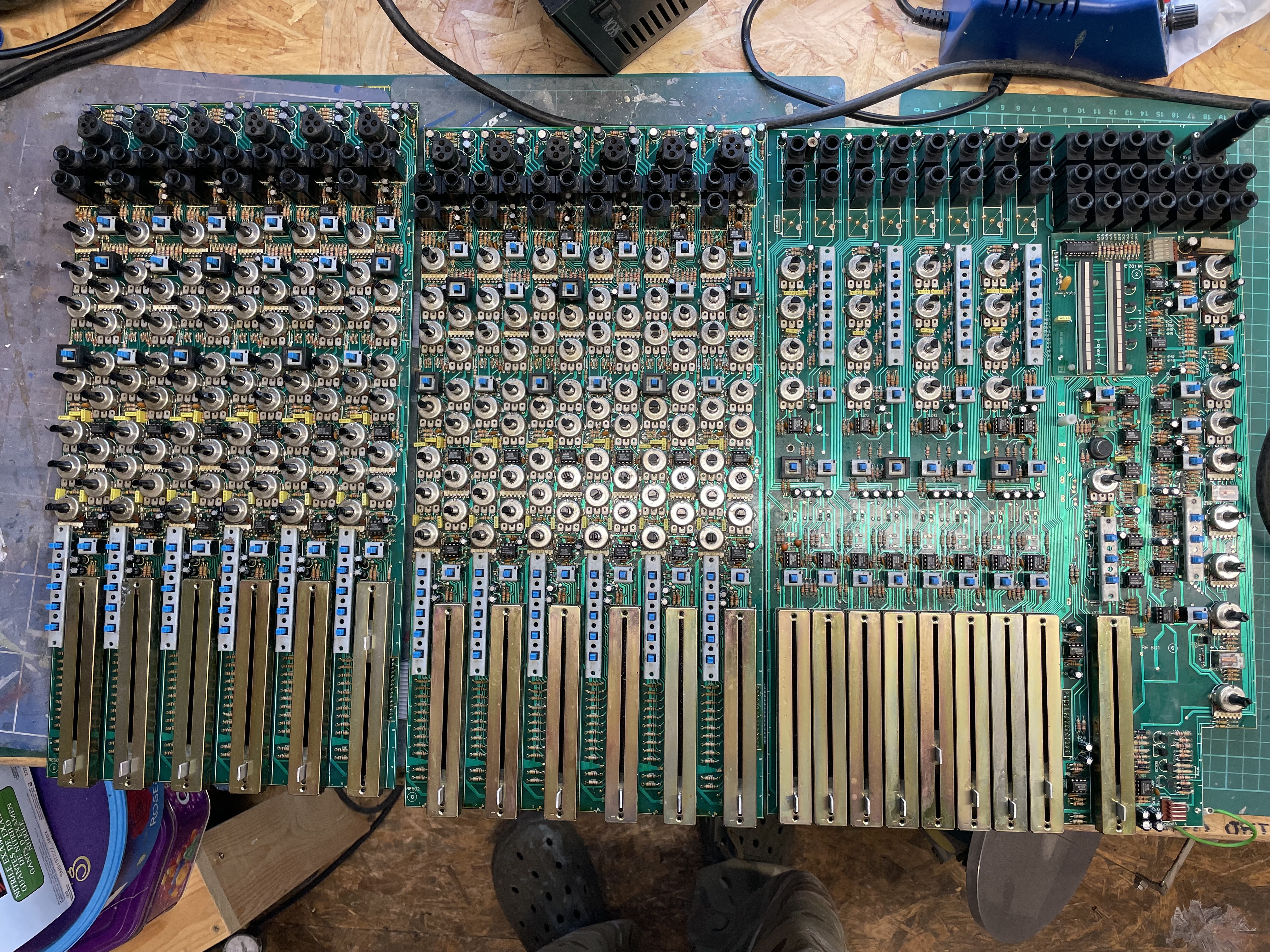

Ok...here is where I'm at.
There is a pic of the three boards that make up the mixer. The two on the left are two boards of six input channels and the right most board is the master /group section.
After a strip down and a thorough clean (Ahhh the 80's/90's when everyone smoked like a chimney over the desk!)
The mixer powers up totally fine with the group section. So adding the middle input board, again, all is fine. The problem is with the first bank of inputs (left most board). When adding this board, the switch on has a buzz and no lights work and in fact, nothing really works at all, whereas with the working boards, inputs all work, meters, solos etc.
I've listed all the capacitors on each board and there's 1 Tantalum on the underside of the input board and a bunch of radial electrolytics dotted throughout. My temptation is to replace the lot and go from there...Is that a good idea? or too much? I could start with the tantalum and test, followed by the radials...and the the ceramics?

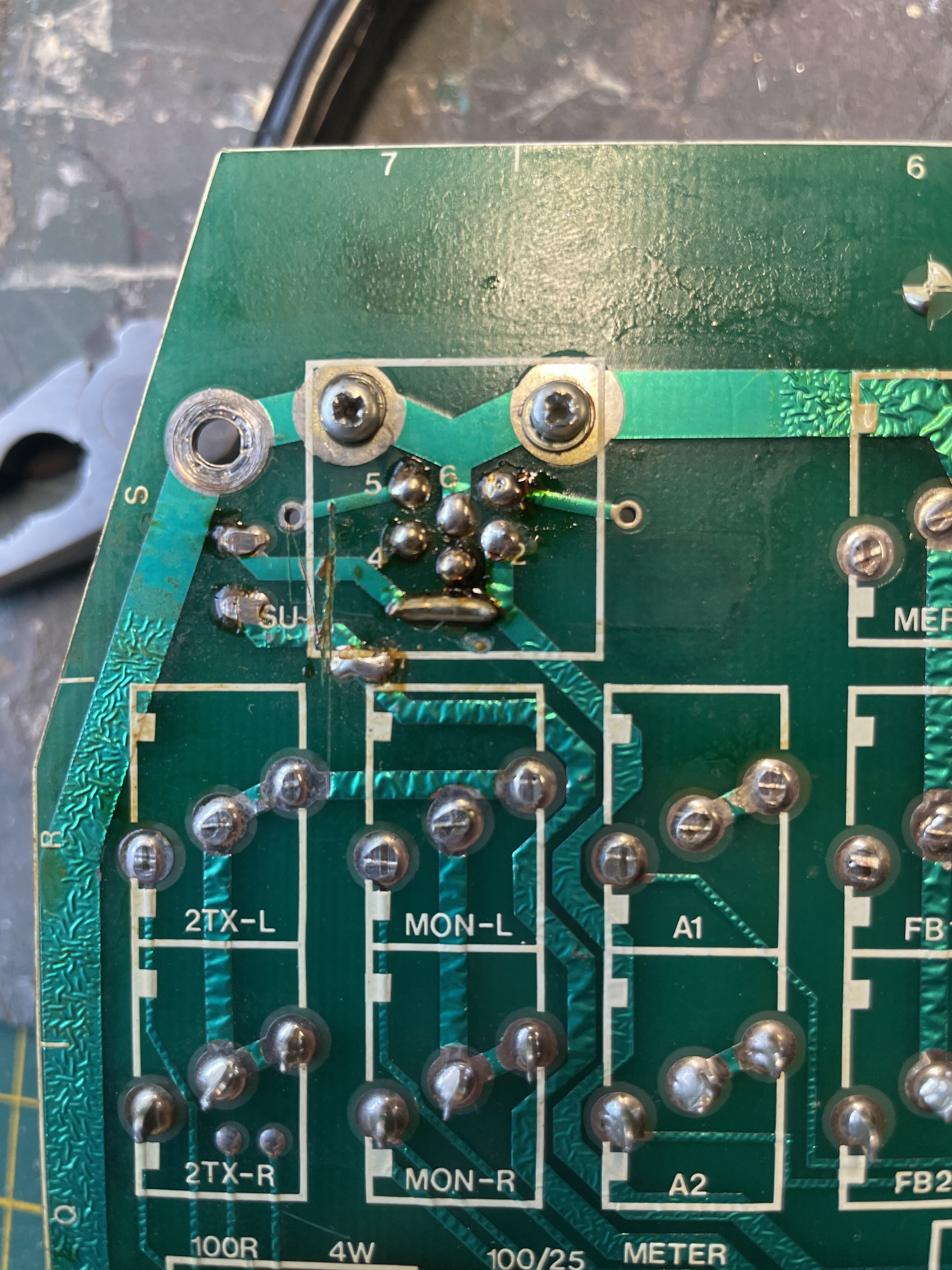

I'm not sure what's going on with the scratch on the power input...the pic looks bad...but the input board works ok, till the other is added..but if I swap the input board so the dodgy one is the only input board then it still freaks out so I'm thinking it isn't a load thing..either way, I wonder if I should fix the tracks?

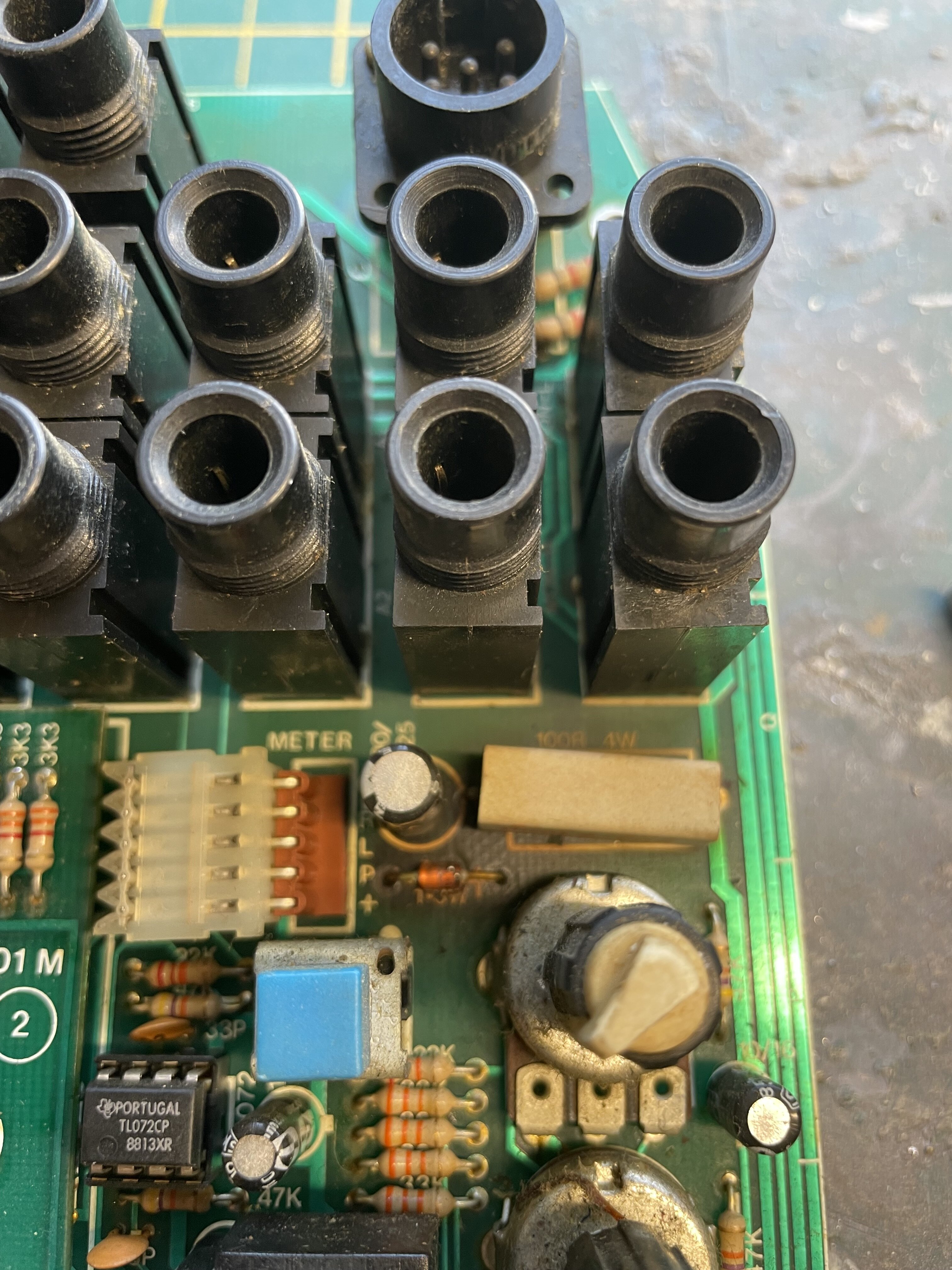

There's also a mark from heat on the underside which on the top side has a big ceramic block resistor type thing so I'm thinking thats wear and tear, and that board it's on works fine, so that could just be a sign of age?

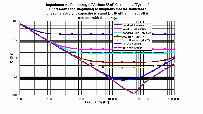

While we are at it.. what’s the actual difference between the tantalum’s and say.. a radial electrolytic? I don’t really know the reasons for using different types of capacitors in different places on the board either but I’d love to know..
Pete
Electrolytic's fail, but tantalums are even worse - and very commonly go S/C - electrolytics usually go high ESR. The reasons for using different types are often simply down to cost, there are rare circumstances where tantalums are better, such as timing capacitors on 555's, as they are lower leakage.
Other people here claim tantalums are fine, and only fail because you're not using high enough voltage versions - however, 35V tantalums on 12V regulated rails commonly fail, so three times rating obviously isn't high enough :D You might have notices the ones in your PSU were rated at 35V on a 15V rail and at 35V on an unregulated 25V rail.

Yes, put the electrolytic in, 2.2uF at 50V is perfectly fine - there's nothing in a mixer that 'needs' a Tantalum, and for that matter very little else that ever does. It 'might' be perfectly OK without it, but presumably it was added for a reason? - so stick the electrolytic in it's place. You might also replace the one on the other input board, as that will probably fail in the near future.
Tants versus other caps, ESR effectiveness -
The OSC-CONs are polymer caps
Mixer performance, rejection of supply rail noise, PSRR of OpAmps for example,
usually speced in a test circuit that includes proper bypassing. So just check how
design was done, and whats hung off the supply rails that could be noise
generators. Eg. considerations when subing lower performance capacitors.
Regards, Dana.
I’ll put the ones I have in their place for now and see how it goes… there’s one per board so it can’t be bad can it? (Famous last words!)...but also...what exactly is ESR?
Pete
Pete
It's 'equivalent series resistance', don't worry about Danadak's 'doom and gloom', electrolytics are perfectly fine in pretty well every circuit, and certainly so in your mixer. If ESR was an issue the capacitor wouldn't be as small as 2.2uF :D
'Generally' ESR is a problem in switch-mode power supplies, and usually where they fit sub-standard quality capacitors - often with design life's of less than 12 months. If you replace them with decent quality components, they never fail again (at least in the life time of the unit). You don't seem to see tantalum capacitors in such use, presumably their reliability would do too low?.
