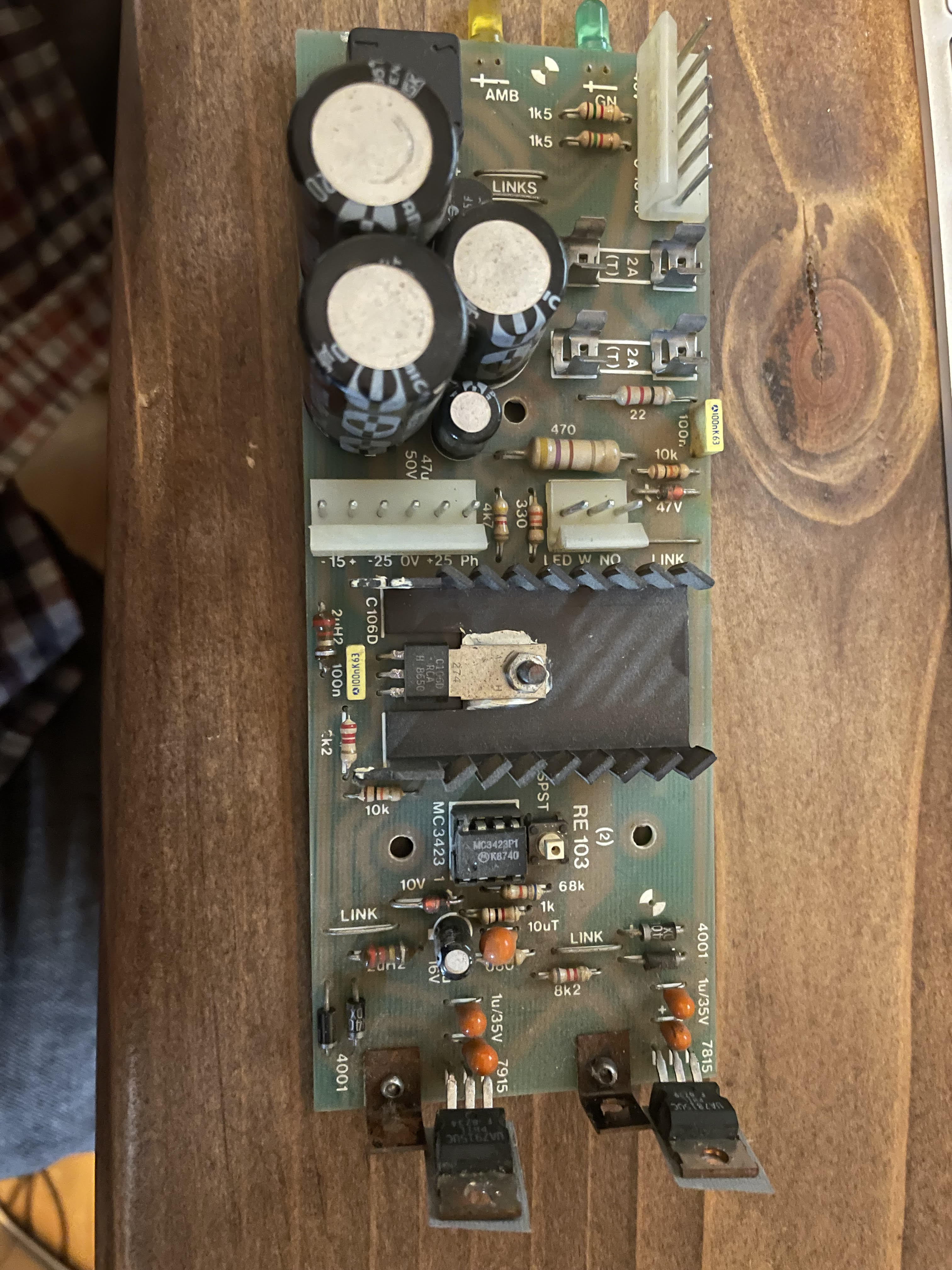

Forgive me for maybe being not the most adept with all this but I ned a little help. I've got a PSU for a Seck 1282 Mixing desk from the 80's and I'm trying to get to the bottom of why the fuse keeps blowing. I had it in storage for a few years and recently got it out to start using it once more and when plugging it in, the fuse pops...there are 2X2A quick blows.

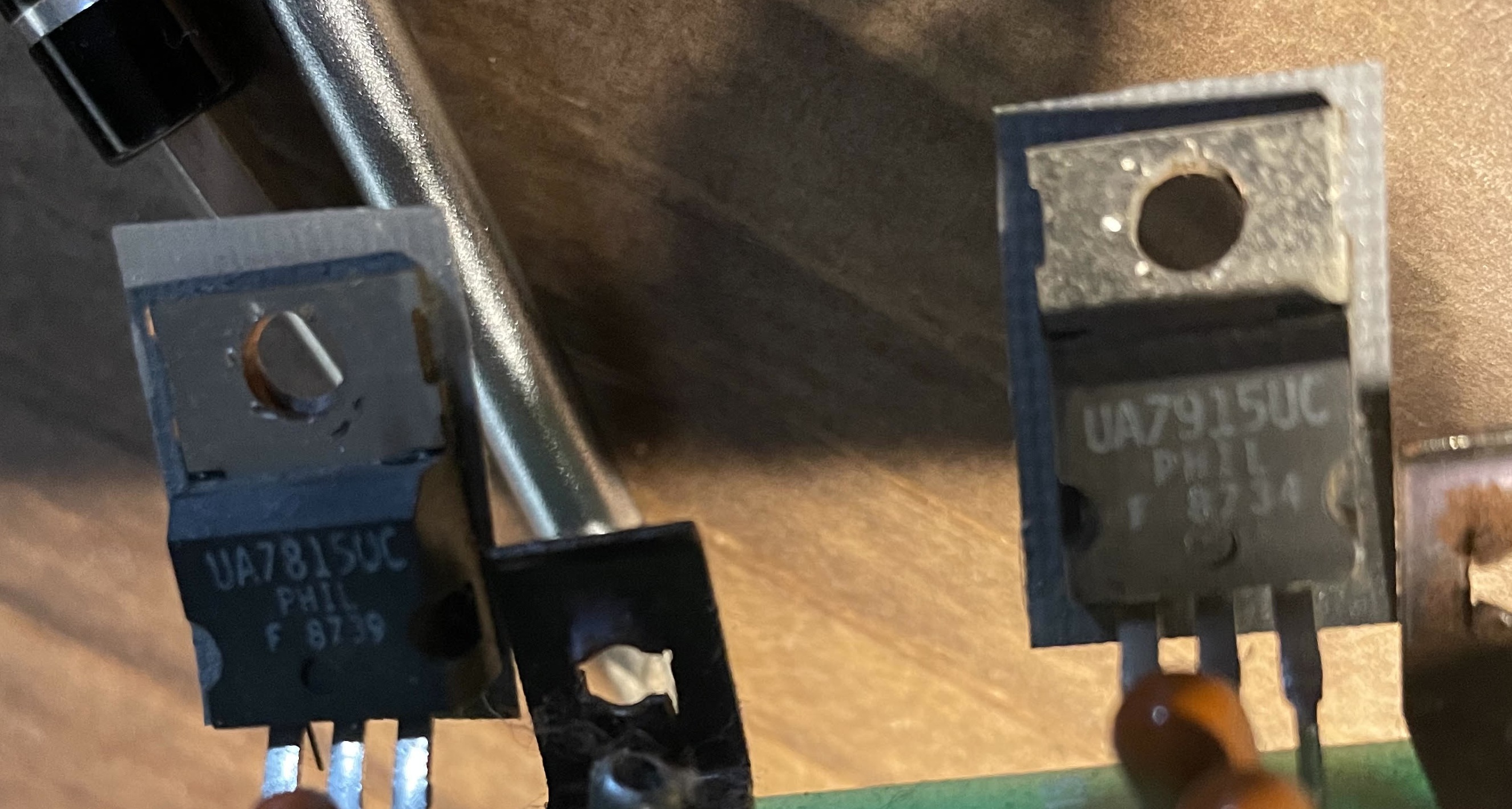

So I searched the net and found the service manual (No luck on a replacement PSU though). It states that the fuses will blow if either of the Voltage regulators are faulty as Each regulator is on the 15V and 24V path. As both fuses are popping, I'm wondering if both regulators are faulty. I'm fairly novice at all this but I do have a basic grasp of electronics and as the desk is old (And left behind by an old friend who no longer wants it) I feel like I've nothing much to lose in having a go at fixing the PSU. In the picture you can see both regulators and I've found out that they are old Fairchild parts, I am in the dark as to how I find a modern equivalent. If I could swap them out with new ones, then at least I could eliminate them from enquiries...I've got no problems in the soldering side as I am always building Modular synth parts from kits etc, it's just wehn something goes wrong, I'm still learning about how to diagnose...I'd love to learn more though!

Nothing difficult about those, they are simple 15V regulators, the 7815 is +ve, and the 7915 is -ve, they are standard components and don't need to be Fairchild.
I wouldn't normally consider either to be most likely to blow fuses, the bridge rectifier BR22 is more likely, and is easily checked using a meter on the diode test range. However, if that checks OK, then there is a chance of the regulators blowing fuses, as there's a crowbar circuit (C106D and MC3423) on the output of the regulators, this is designed to blow the fuses if the regulators fail, to protect the rest of the mixer.
I presume CN3 at the right hand side is a plug/socket and can be simply unplugged? - this would allow you to work on it with no danger to the rest of the mixer

Now I can see the IC and the 106 component, but I still need a bit of help understanding the basics of what it all means..
So...If I attach a picture of the board, is the BR22 obvious? Is it the square part near the large Capacitors?How should I go about testing it? I've got a meter but till now, I've normally used it to check resistor values and checking cables work...Any help is greatly appreciated as forums like this are so helpful to me ...web pages etc normally assume some prior knowledge if you know what I mean..

BR22 is a bridge rectifier, and the fuses connect to it, it's the square component at the top, above the capacitors in your last picture. It's essentially four diodes in one unit, so you test it like four diodes.

unsolder the leads to the thyristor and bend them out of the board, then see if it continues to blow fuses. i have a collection of old analog open-frame power supplies that had a similar crowbar circuit in all of them., and got them all because they blew fuses, and the company i worked for was more likely to replace them and throw them out than try to fix them. in every case, the thyristor was shorted, and that's what was blowing the fuses.
Is that the three legged component in the centre of the board screwed to the heat sink? Is there a way to test it before unsoldering it, or can it not be reliably tested whilst on the board?

At this point I was eating up fuses so I thought I’d swap out the regulators.. the 7815/7915 regulators…
Pop…
Hmmm aside from the ceramic capacitors (which I’ve got a bunch of) the only big bit to replace is the 106 in the middle screwed down… I’m wondering if I should get one of those and replace that.. kind of miffed that I didn’t get any of them when I ordered the rest from mouser, I only need one! Plus I’m unsure about how to source one that’s the same dimensions, also, with the metal plate so it can be screwed down or is that not as important?
Pete
As I explained earlier, the BT106 is a crowbar circuit, designed to blow the fuse and to do nothing else. Take it out and test the PSU without it - but DON'T PLUG THE REST OF THE MIXER IN TO THE PSU - just power in to the PSU, and nothing else connected.
Assuming it doesn't blow the fuse?, then measure the output voltages which should be +15V and -15V. Assuming they are OK?, either the BT106 is faulty, or the IC feeding it.
