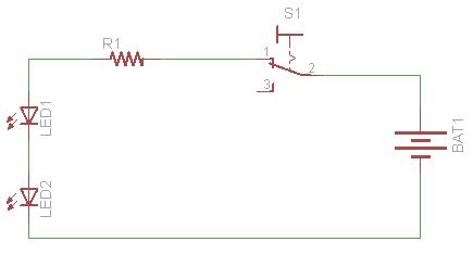

Toggle switch connection?
Question!!
I need to connect my circuit to a mini toggle switch so I can turn the circuit for the LCD's on and off. The switch has 3 contact points on the bottom of it, which I'll assume are +, -, and common, which is the center contact.
Do I simply connect the + and - circuit to the + and - on the switch, or do I need to connect one of the lines to the + or - and the other to the common poistion (middle)?

No, the pins are not +, -, and common. I would assume it is more like +, -, +, though this does not actually represent polarity. The - pin (which is common) connects to one side or the other, depending on how it is toggled. To connect your circuit, look at this simple diagram:
The symbol on the far right (what looks like a bunch of "stacked" lines) is the battery. The longest line on the end means the positive side of the battery. The funny-looking symbol on the top right is the switch. The third pin (the second "+") of the switch is not connected. Other than that, it does not matter which of the remaining 2 pins of the switch connects to which part of the circuit. The jagged line is your resistor, and the arrows on the left are your LEDs.
I hope this helps!
Der Strom

One more question, so I bring my circuit to the LED's which both have a + and - connector. Do I run my + wire from my switch to the + LED connection? Then connect a wire to the - side of that LED which in turn connects to the + connector on the next LED, then connect the - side of that LED back to the toggle switch? Sorry, I don't have a scanner here at work that I can use to create and upload a drawing of this, but I do at home and will do so when I get there tonight.

First, you must connect the positive (+) terminal of your battery to the middle pin of your toggle switch. Then, connect one of the outer pins to your resistor. Connect the other side of your resistor to the (+) side of your first LED, then connect the (-) side of that LED to the (+) of your second one. Finally, connect the (-) side of your second LED to the negative (-) terminal of your battery. And that should be it! You should now be able to turn your LEDs on and off with the toggle switch.
Der Strom
Thanks DerStrom8, the project came together perfectly. I appreciate the help.
