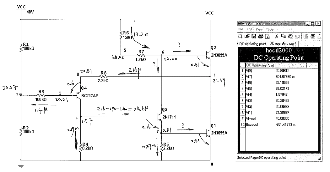

I enclosed another picture with DC operating point simulated by MultiSim. The current through R8 is much less than 3.553mA, by using (V1-V8)/R8=0.216mA. Strange, may be I was not correctly using the software when it producing 3.553mA...
Based on the DC operating points, I can calcuate the currents flowing in most of the segment, except the base current into Q1 and Q2, plus the collect current of Q3:
- Ie4=(V1-V8)/R8=216u, Ib4=IR3=(V3-V2)/R3=1.4u, so Ic4=Ie4-Ib4=214.6u
- IR5=V4/R4=190u, so Ib3=Ic4-IR4=214.6-190=24.6u
- IR6=IR7=(Vcc-V6)/(R6+R7)=13.2m
- IR5=V5/R5=370u
then I stuck at this point, without knowing how IR7 is splitted at node 6, and then how Ie3 should be...

Picture with the current calculations, based on sim result.

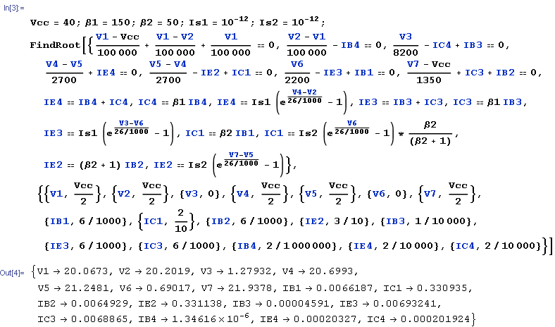

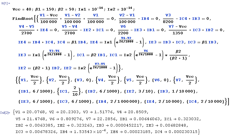

It's possible to analyze the circuit and get all the currents and voltages if you set up 17 equations in 17 unknowns. The system can be solved easily with a mathematical assistant program.

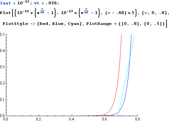

I used the Shockley equation for the Vbe-Ie characteristic of the transistors. In order to get a Vbe of about .8 volt for Q1 and Q1, it's necessary to use a saturation current, Is, of 10^-14. I don't think this is realistic. A 2N3055 isn't going to have a Vbe of .8 volts at room temperature with a base current of only 5 milliamps or so.
I've attached 3 images. The first shows Vbe curves for two different saturation currents plus a linear approximation.
The second image shows the network solution with Is chosen so that the Vbe of Q1 and Q2 is about .8 volts. This corresponds with the numbers you got fairly closely.
The third image uses a reduced saturation current for the transistors of 10^-12, which I think may be more realistic.
The designators for currents should be obvious; IC2 = collector current of Q2, IB1 = base current of Q1, etc.
I used different node numbering than you did.
     My      Your
    node     node
   number   number
     1        2
     2        3
     3        4
     4        8
     5        1
     6        7
     7        6
