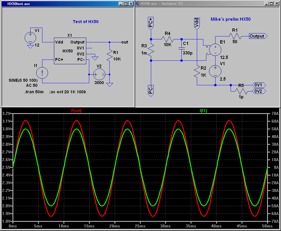

Here is a hack at it:

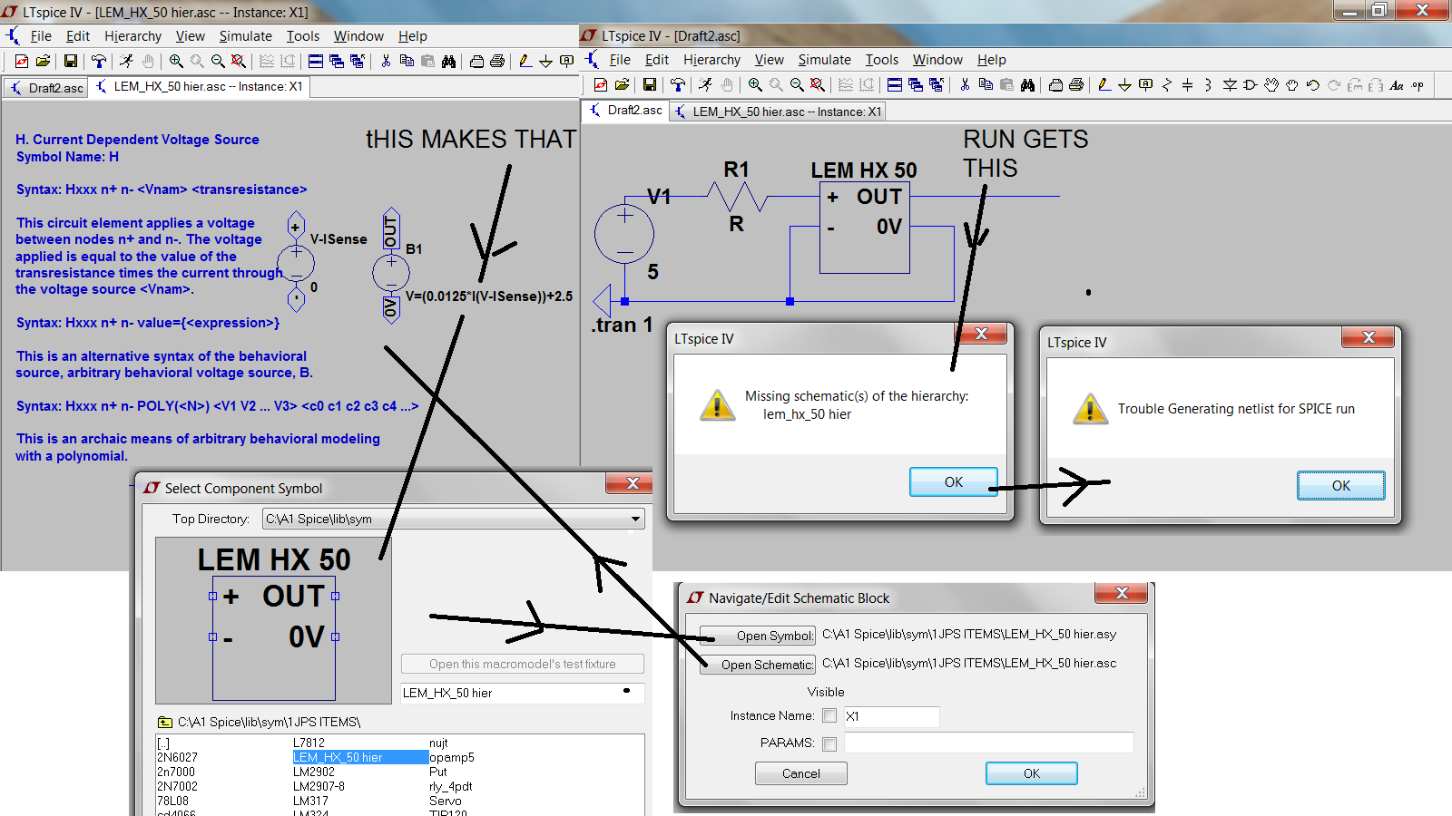

Or you can just use a hierarchical schematic like I used. LTSpice has the ability to define what would otherwise be a .SUB using their graphics editor instead of a text editor. I created the schematic model of the HX50 directly from the data sheet. I put I/O ports on it. I then let LTSpice create the symbol automatically. I massaged it to make it more user friendly. I then placed that new symbol in the test circuit.
If you insist on having a .txt or.sub text file instead of using the hierarchical schematic, then save the netlist that is created during a SIM run using my example, and extract the .SUB from that.
Since one of the salient properties of the HX50 is its frequency response, it is much more natural to use the voltage-controlled voltage source I used in my model. That allowed me to model the low-pass frequency response by placing the RC between the current sampling resistor and the VCVS.
Even though the HX50 uses a Hall-Effect sensor, I'll bet that the internal resistance of the traces inside the package are higher than the 1 milliOhm I used to convert current to voltage.
Thanks Mike, still working on your suggestions, but the HX50 s don't seem to give the desired results, that is at 0 current, out should be 2.5v and at 50 amps out should be 3.125v. chech the picture

Any symbol I have made from a workable schematic using the hierarchy function always fails and usually says it can't find the schematic, see "still not working .png

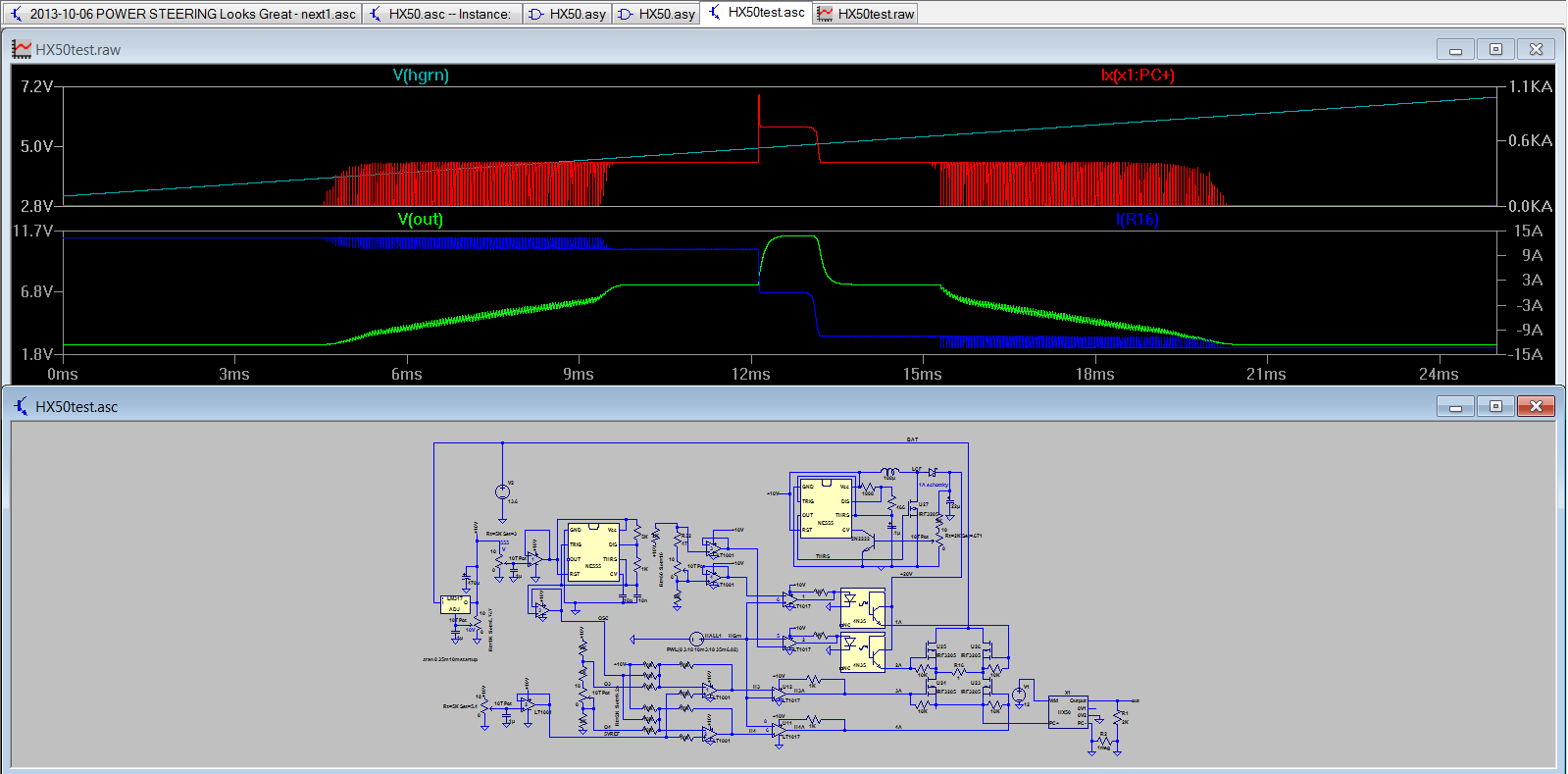

I keep thinking I'm working with dc, but then I remember I have a 20KHz oscillator. If you want to see where I using the LEM HX50, it's in the 2013-10-06 POWER STEERING Looks Great - next.asc.
It's not quite done yet, the output of the LEM will trip the relay when the motor reaches it's end of travel and replacing the output of the Hall, which is responsive to steering wheel torque, with the nuetral voltage of 5v, now I need to hold the relay in until the torque is back to 0.
