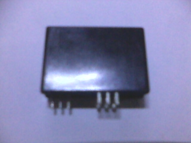

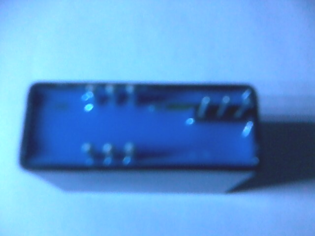

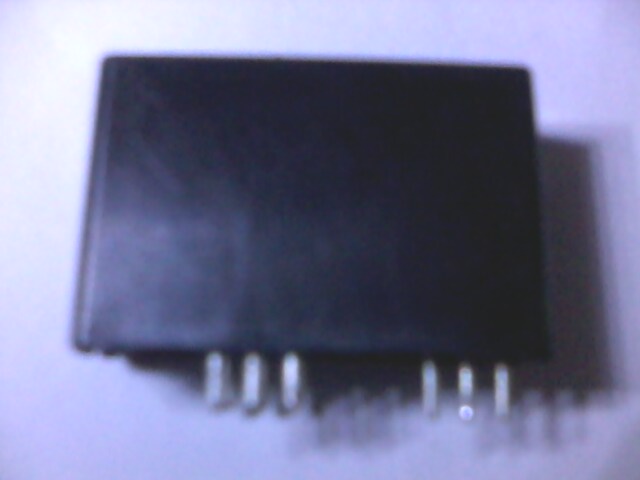

Hi!
IMG0298A.jpgIMG0297A.jpgIMG0295A.jpg this is the photo of the current transducer that I have. It has 9 pins, that's why I'm having a hard time figuring the pins function.
the part number that was written at product is MYS 01 CSNE151-104.
I know vendors sometimes "customize" their products for a specific application. They append letters or numbers to a catalog component to indicate certain customization. That could be the meaning of the -104 suffix.
If that is the case, then you have to go MrAl's route as explained in his last paragraph.
Hello again,
Well if you cant find any other info about it you may have to contact the manufacturer and hope they can come up with something. Otherwise, try measuring the resistance of the 6 pin set on the left and see it they look like separate primary coils. It will be hard to tell which pin on the right is positive and negative however.

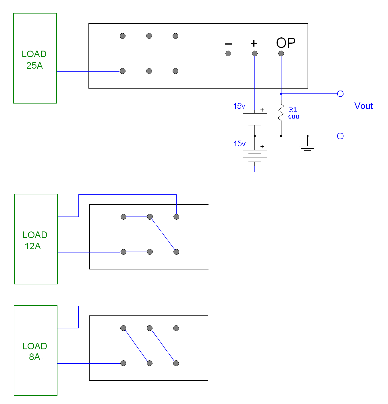

I found a similar one too, and it appears that the three terminals that stand alone are:
Minus
Plus
O/P
with the O/P pin nearest the case on the right.
The voltage is probably plus and minus 15 volts. If you want to try plus and minus 5v first that's up to you, then go higher.
The O/P pin however requires a resistor to the ground lead of the two power supplies. Since this model puts out 12.5ma that means a 400 ohm resistor would produce a 5v full scale voltage, but you may want to go slightly under that value to allow for a peak a little higher.
The 6 pins are most likely three primary windings, where the starts and finishes of each winding are the pairs of pins (so you have three pairs). You can wind them in parallel for max currernt sensing, or in series for min current sensing. Since the max rated current is 25 amps, in parallel you could sense 25 amps and in series about 8 amps.
Here's a quick drawing showing the three windings and the two supply connections and the OP pin:

Hello again,
Ok, but your device doesnt have those two extra pins right? That would be for the 5 volt power supply.
So our best guess so far is as i posted previously. You can try 5 volts first though, and the drawing you show also shows us the primary connections for three different sense currents.
Yup, I Don't have those extra pins. I'll try it first.

Hi again MrAl,
I have this Diagram, I was wondering on where would I get this Io and Ii? would that be the "+","-" DC that was coming from the load? I'm really confuse.
Thanks.
Check this drawing...
