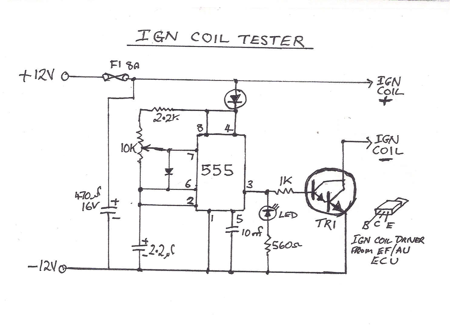

This is what I use for testing Ign Coils & Injectors. The driver transistor is a 2SD1071.
This is what I use for testing Ign Coils & Injectors. The driver transistor is a 2SD1071.View attachment 98436
I would want to put some sort of protection on that circuit, at the very least a freewheel diode across the coil. Otherwise you risk destroying your transistor and 555 circuitry from the BEMF.
Ive used this circuit a lot on allsorts of Ign coils & never had any trouble. The 2SD1071 is an Ign coil driver transistor Darlington type & does have an internal diode betwean Emitter & Collector.
Hi debe,
Nice design- simple, but effective. :cool:
spec
(one little point: on your circuit the OV line is labeled '-12V' suggest that would be better labeled '0V')
Isn't the output LED backwards?
Hi DS8,
As debe says, there is a negative built in catching diode in the transistor. Of course, you can't catch the positive approx 400V voltage swing at 12V because that would dissipate the energy in the coil and suppress the spark.
spec
