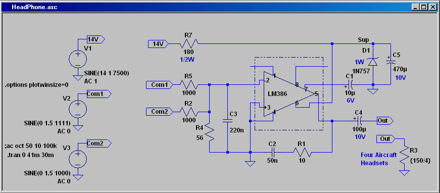

I need an IC for a mono amplifier:
Primary input power: 14Vdc with alternator ripple, typical automotive (i.e. needs good PSRR).
Output: 6Vp-p into 35Ω load.
Gain: 1 (unity, inverting ok).
Two switched inputs: (need isolation between inputs, i.e. "summing amp", level on input A not effected by input B being switched on-off, and vice-versa).
Input impedance: ≥ 500Ω, single ended, ground referenced.
Frequency Response: flat between 100 to 5000Hz with 6db per octave roll-off above and below.
It seems a standard opamp cannot drive a 35Ω load. I'm thinking LM386N1? Other suggestions??
Here is what I came up with:

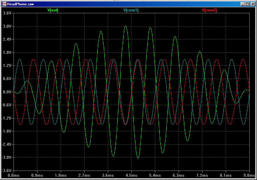

First Plot is Time Domain response with 1000Hz and 1111Hz inputs, and with 2Vp-p of simulated alternator ripple on the 14V input.

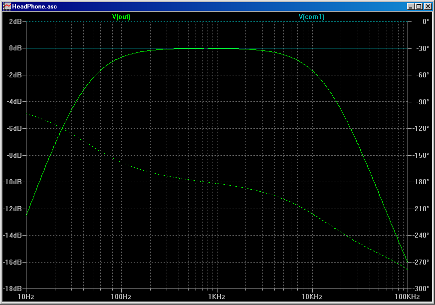

Second Plot is the frequency response with a single input, showing unity gain
Third Plot is the frequency response with both inputs, showing gain of 2, sum of the the two inputs.

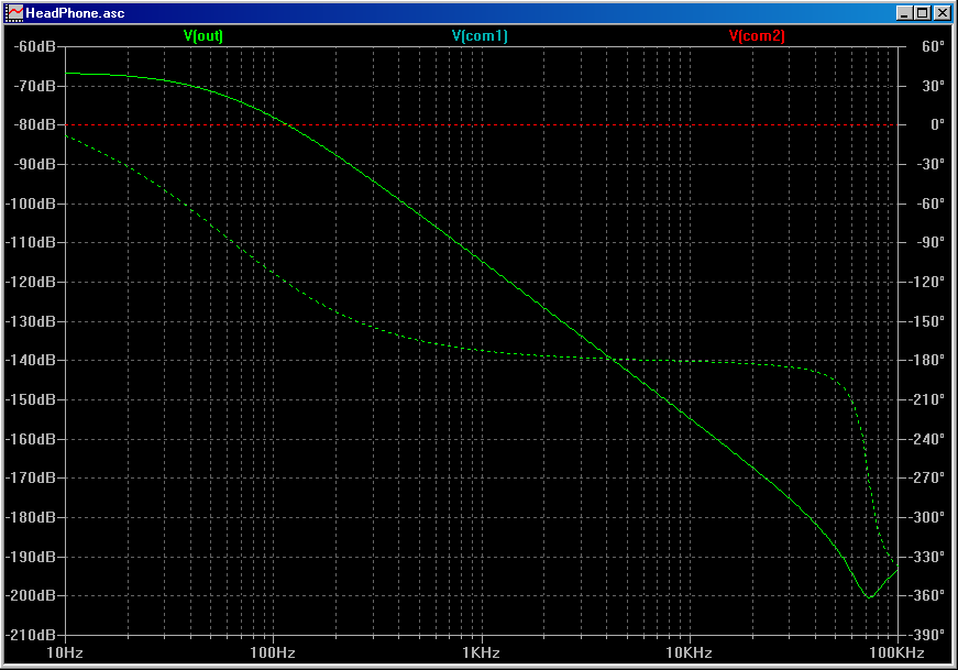

Fourth Plot is the Power Supply Rejection Ratio from the 14V input port to the Output.

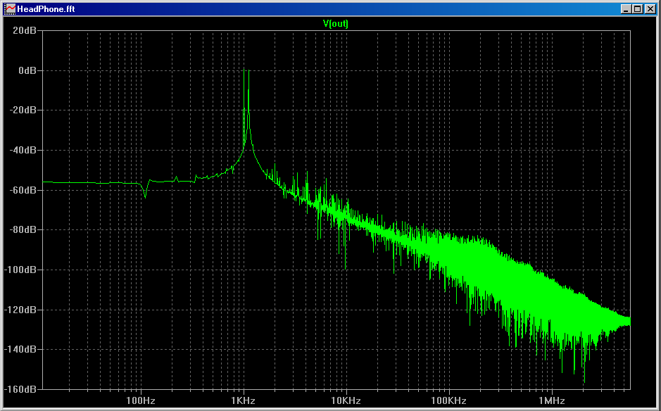

Fifth Plot is the FFT of the time domain response, showing low intermod between the inputs and good suppression of the alternator ripple.
