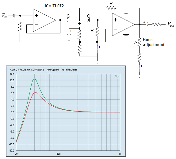

Are you using a cell phone to play MP3's? If it doesn't produce bass frequencies then an amplifier will not help. Instead you need a bass-boost circuit.
any references, audioguru? i need some reference on basics too.. like, what opamp would b best and its various configurations for bass...
I made a bass boost circuit for my stereo.
I measured the frequency response from the speakers that dropped -3dB at 65Hz and made an adjustable boost that compensates. It peaks at 40Hz.
The bass boost uses extra power from the amplifier which might damage cheap speakers or cause the amplifier to clip.
I use TL071 single, tL072 dual and TL074 quad low noise audio opamps.

I designed and used the circuit many years ago. Then Silicon Chip magazine in Australia published it.
Maybe their signal generator connected to a pc to make the graph.
