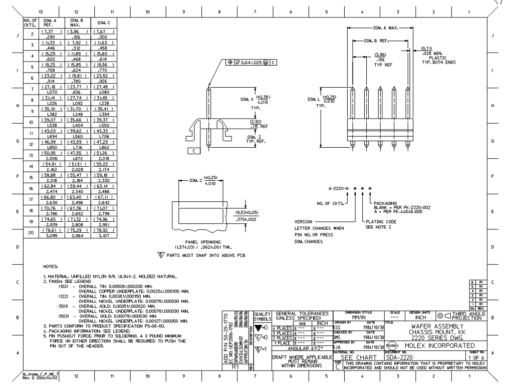

hi SC,
These are the same type as I suggested, commonly referred to as Molex connectors, available in 0.1inch for signal wires or 0.2inch pitch for power wires.
Eric, I think we're talking about two different things here? He didn't want to find a supplier for the headers. He wanted to find a supplier for the connectors to those headers. I can't find connectors on the link your provided in post #2, the parametric search seems a little flakey can you provide a specific part number at Farnell to what you think is a good solution, and the image you posted in post #9 is for headers not the connectors to them.
