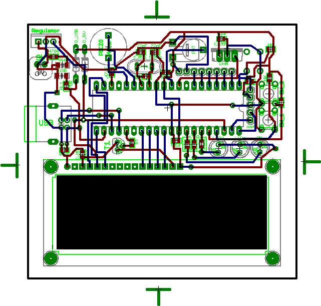

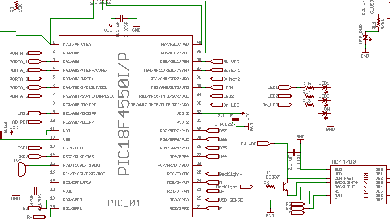

Hi im trying to control a 44870 lcd with a pic18f4550.
It seems everytime i try and do LCD i run into problems. Im running out of hair to pull out.
I have tried the microchip c18 XLCD library, and my own lcd code, but neither work.
I have included my code, and circuit diagram.
The code project is a slightly modified Microchip usb framework.
The code that im trying to get working resides inside LCD.c and PinDefs.h.
it would seem that Im failing to initialise the lcd properly.
Can anyone see any obvious mistakes im making?
Many thanks.
Chris
An obvious problem is no contrast control, depending on your specific LCD (and the ambient temperature) you may very well not be able to see if it's working or not?.
Add a contrast control, and then try adjusting it - if the LCD isn't initialised you should be able to adjust it so you can see a single row of solid black squares (this works without the PIC there at all).
I had a quick look at the code and the only thing I immediately spotted is that to send a command you have to still send both nibbles and clear RS. Also, your initialisation doesn't appear correct, there is a sequence of writes and delays that have to be preformed.
OK cheers mate, ill have a go atthe contrast thing. I had completely overlooked that:eek: .
My code is messy and horrible, because it is the product of many hours of tedious pointless modification. It doesn't work with the Microchip code either.
Anyway thanks for the quick reply:D

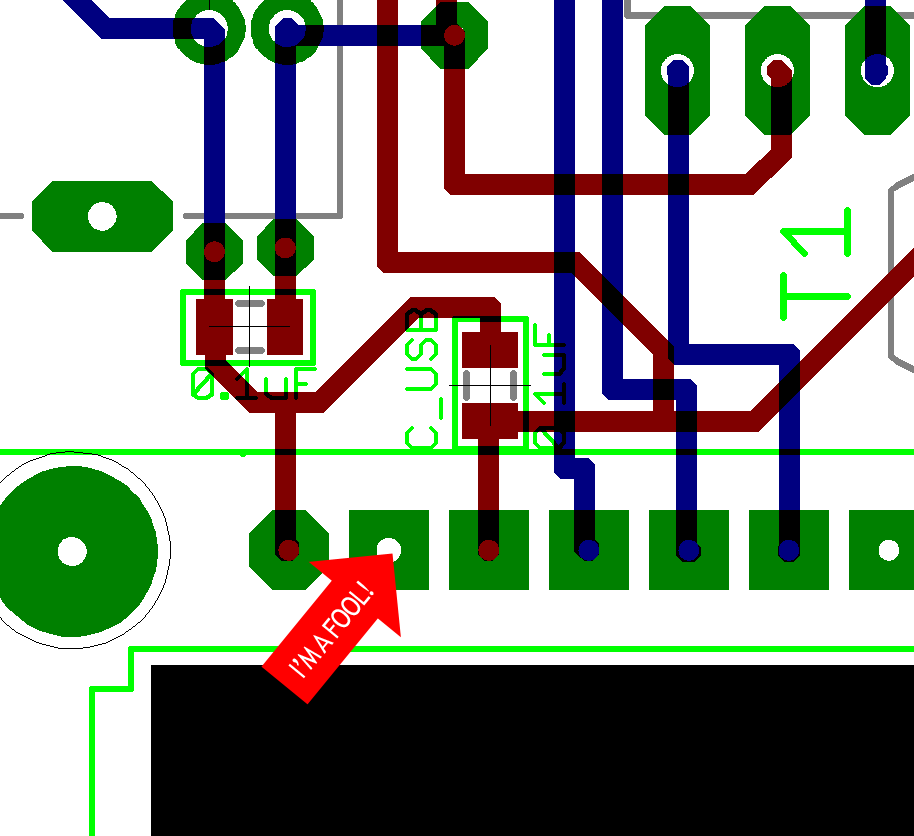

When i started poking around at the board, I discovered something foolish.
What I appear to have done is instead of connecting 5v+ to pin2, i connected it to pin3(CONTRAST).
My schematic shows that both pin2 and 3 are connected to vdd, so why has eagle forgotten to connect an air wire to pin2?
Cheers

Your initialisation is still wrong.
The data sheet states,
After Power On,
Wait more than 15mS
Send Nibble 0x30
Wait more than 5mS
Send Nibble 0x30
Wait more than 100uS
Send Nibble 0x30
Send Nibble 0x20
The display is now initialised in 4 bit mode.
In you case you will send 0x03 instead of 0x30 as you swap nibbles in your routine.
Please keep in mind that the LCD won't do anything as long as it didn't receive 8 bits = 1 byte, even in 4 bit mode.
So forget your "SendCmdNibble" routine.
After sending 1 nibble, the LCD won't execute nothing, since it's still missing 4 bits.
You always need to send 8 bits or 1 byte!!

After making modifications to the board, The LCD now turns on, before it was just the backlight!
I can also see the 16x2 'place holder' blocks now i have connected the contrast directly to ground(before it was routed to vdd).
Any way thanks again everyone for the replies, i really appreciate all your help on this matter.
Cheers,
Chris
p.s will post again when it doesnt work!
