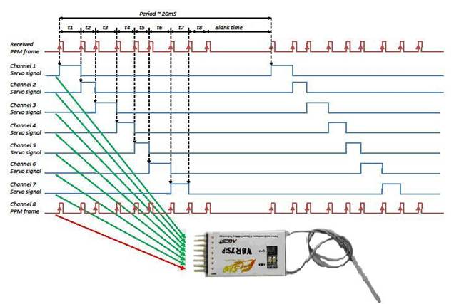

So, is the 74HC164 the best choice?
Yes, absolutely - for this specific application.
The idea is to shift one bit through, so it sets each output high in turn. The "flicker" if you like, but that is a sequence of servo pulses.
The clock input to shift it will come from the output compare pin so the timing is then purely hardware, and software delays cannot cause jitter - the software has plenty of time just to set up the next compare each time.
The 595 is ideal as as "output expander" for normal things like switching LEDs or relays, as you can shift data in without affecting the pins then transfer it to the latch once it's in the correct bit alignment.
It needs more control signals though so it can only be driven via a software routine, which means the likelihood of jitter again.

One possible issue with the 74HC164 is as the BITs are filling the BYTE, if they don't fill fast enough, they have a momentary voltage, I am assuming that the PIC that clocks them is too fast to worry about.
That's not a problem, it is essential for how this setup works!
Look at the actual RC signal waveforms I posted earlier on:
The shift register moves a single bit through to each output in turn - like the "Channel x Servo signals"
The PPM waveform at the top is from the PIC compare hardware rather than a radio receiver, shifting the bit each 1 - 2 mS as appropriate for each respective servo position.
Unless the outputs changes as the SR was clocked, there would not be any servo outputs!
For decades, Radio control receivers used to use a shift reg IC for the conversion back to servo pulses, before MCU based ones took over.
ps. If you need to translate to 5V power for the shift register, it should have been a 74HCT164
The HCT ones take TTL levels and 3.3V logic is perfect to feed those with the HCT device working on 5V.
