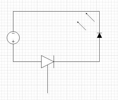

I made a simple thyristor circuit using an MCR 100-6 and an LED in series. When I pump 5V to the circuit, even earthing the gate of the SCR switched the LED on. When I use 3.3V instead, this doesn't happen. Why is this?
Show us the circuit.
When I use a 5V power source, connecting the gate to ground will switch the LED on.
When I use a 3.3V source, this does not happen.

What is "ground" in you circuit? Is this your exact circuit, or do you have a current-limiting resistor in series with the LED?
Ken
I just connected one end of a long earthed wire to the gate... and no, I don't have a current limiting resistor.
Since your circuit is isolated from earth-ground, the long wire just forms one plate of a capacitor. When you touch the wire to ground, the discharge of any static charge developed on the wire triggers the gate. It's a very unpredictable and potential dangers condition for the SCR. In a very dry atmosphere you might get a high enough voltage on the wire to blow the gate-cathode junction. Also you need to insert a current limiting resistor to protect the LED. If you haven't blown the LED you are lucky.

Actually, I first earthed the wire to discharge any static charge. Then I connected the wire again, only one end connected to the gate. The other was not connected to anything. The wire was 3 m long. The SCR switched on. I tried again with a smaller wire. This didn't happen. And yes, why exactly would I need a current limiting resistor? Even if I connect the LED directly to the 5V source, it doesn't blow up.
Is the wire insulated where you are holding it? Are you physically at earth-ground potential. You can be the source to recharge the wire after it was grounded.
