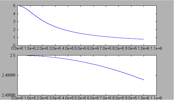

I am very sorry this took so long to generate, but I had a lot of school work and then I needed to learn the syntax of Freemat. Anyway, here it is:
-3dB Point of Ordinary LPF: 15915.49 Hz
-3dB Point of LPF With Load: 15915.49 Hz

Is that correct?

Something doesnt look right in the graphs. How does the amplitude get as high as 5v in the top trace for example?
Well the top graph is without a load, so it should start from 5V, shouldn't it? The lower graph is with the load so it begins at 2.5V. I should have told you beforehand which was which, sorry.
Hi again,
So you are using an input voltage of 5v then? Usually you would use 1v to graph it. Of course it helps to graph in db gain too rather than voltage so you can easily spot the -3db point.
After all that, I need to change the graphs again? ;)
Alright, I'll fix it up and put it in terms of dB. One volt for the input voltage is a good idea, I'll implement that as well.

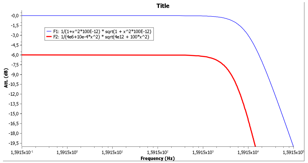

Hey MrAl,
Apparently there is a mistake in our mathematics? Hayato provided the graph that is attached and his equations are different.

Hi MrAl,
I believe our first transfer function is correct, but the second one isn't. I went over the math myself and will show you my results.
Conventional Low-Pass Filter
Final Equation
[LATEX]Amplitude = \frac{V_{IN}}{\sqrt{1 + Z_R^2 \omega^2 C^2[/LATEX]
Low-Pass Filter With Load
[LATEX]i_1 = i_2 + i_3[/LATEX]
[LATEX]i_1 = \frac{V_{IN} - V_O}{R}[/LATEX]
[LATEX]i_2 = V_O j \omega C[/LATEX]
[LATEX]i_3 = \frac{V_O}{R_L}[/LATEX]
[LATEX]\frac{V_{IN} - V_O}{R} = V_O j \omega C + \frac{V_O}{R_L}[/LATEX]
[LATEX]V_{IN} = V_O + V_O R j \omega C + \frac{V_O R}{R_L}[/LATEX]
[LATEX]V_{IN} R_L = V_O + V_O R j \omega C + V_O R[/LATEX]
[LATEX]V_{IN} = V_O(1 + R j \omega C + R)[/LATEX]
[LATEX]V_O = \frac{V_{IN} R_L}{1 + R j \omega C + R}[/LATEX]
[LATEX]\frac{(R_N^2 + I_N^2)}{(R_D^2 + I_D^2)}[/LATEX]
[LATEX]\frac{(V_{IN} R_L)^2}{(1 + R)^2 + (R \omega C)^2}[/LATEX]
[LATEX]Amplitude = \sqrt{\frac{V_{IN}^2 R_L^2}{1 + 2R + R^2 + R^2 \omega ^2 C^2}}[/LATEX]
Final Equation
[LATEX]Amplitude = \frac{V_{IN} R_L}{\sqrt{1 + 2R + R^2 + R^2 \omega^2 C^2}}[/LATEX]
I believe that's correct?

Hello again,
Ok since you only have a problem with the circuit with the load resistor we'll concentrate on that one.
With R1 being the input resistor and R2 being the load resistor and C the only capacitor, the transfer function is:
Vout=(Vin*R2)/(s*C*R1*R2+R1+R2)
and the amplitude (after subst s=j*w) is:
VoutAmpl=(Vin*R2)/sqrt(w^2*C^2*R1^2*R2^2+R2^2+2*R1*R2+R1^2)
Now this last result has been verified in a circuit simulator, which by the way you should be doing too. You can compare your result to that VoutAmpl and if you dont get that or an equivalent expression then it can not be correct so you'll have to see what went wrong.
You might note that both R1 and R2 appear in the denominator too. I also think that using Latex just complicates matters rather than making them simpler. You should probably avoid that until you get the final correct solution.
