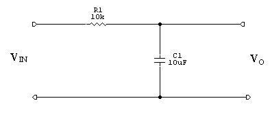

Hey Everyone,
I ordered a HP-50G calculator recently, which should arrive sometime soon, for school this year. I would like to graph several transfer curves of various filters. For instance, I would like to graph the transfer function of the following of a typical RC low-pass filter (see attachment):
  • C = 10µF
  • R = 10kΩ
  • Vin = 5V
The equations below apply:
[LATEX]V_O = V_I_N \frac{X_C}{Z}[/LATEX]
Where:
• [LATEX]X_C = \frac{1}{j \omega C}[/LATEX]
• [LATEX]Z = \sqrt{R^2 + X_C^2}[/LATEX]
Therefore:
[LATEX]V_O = \frac{\frac{1}{j \omega C}}{\sqrt{R^2 + (\frac{1}{j \omega C})^2[/LATEX]
Graphing with a complex number kind of throws me off, would someone show me how to graph the equation with the values above?
I'd appreciate any help!

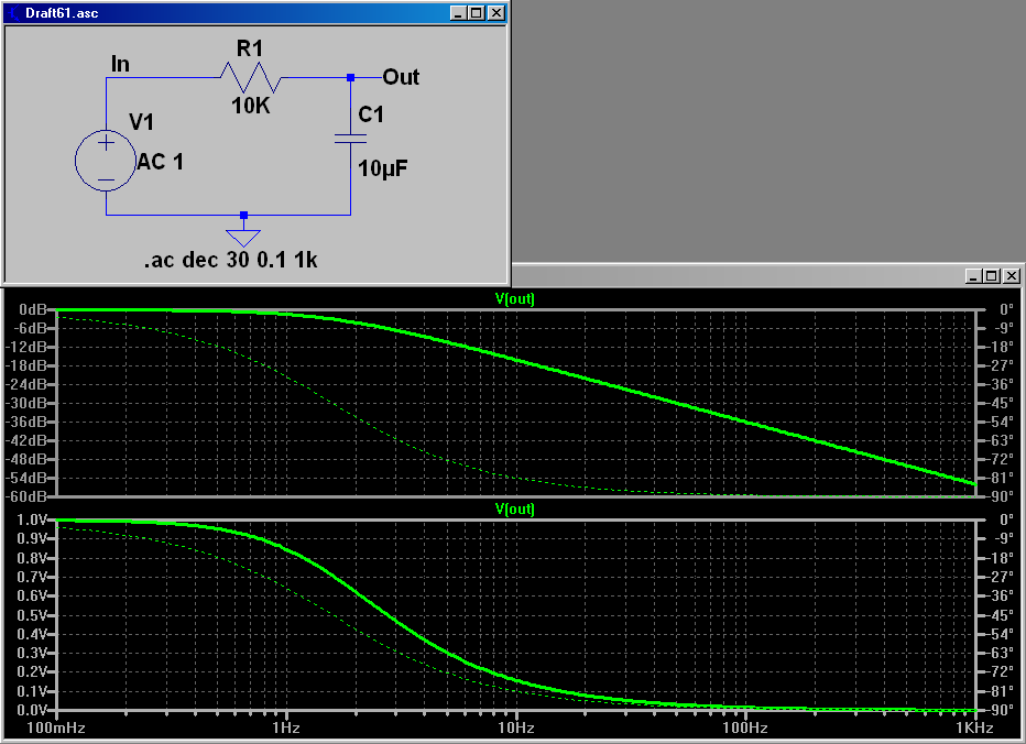

Here it is using FREE LTSpice. It took less than 1 minute to build the schematic and simulate it...

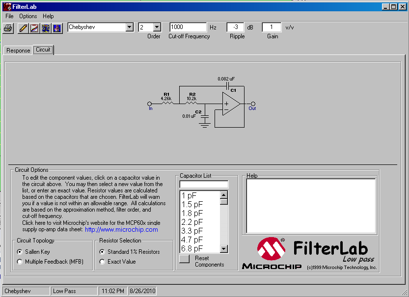

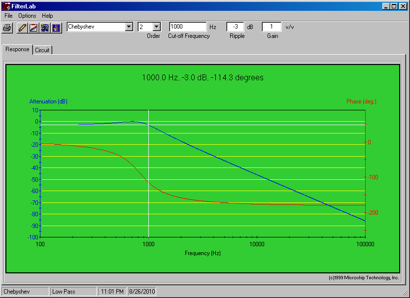

That was the mathematics for a first-order RC low pass filter, what about a second order one? :)

Hey,
There are a couple things I’d like to address before we get into second-order filters that I just thought of.
• What parameters will increase the bandwidth of my first-order RC LPF?
• What is the effect of increasing resistance while lowering capacitance? For instance, if I originally had 1k and 10nF but changed it to 10k and 1nF? In the equations, I still get the same RC time constant so it seems to have no effect, yet I believe it must do something?
• Likewise, what is the effect of increasing capacitance while lowering resistance?
• What is the effect of increasing voltage?
After these questions are addressed, I’d like to do the mathematics for a high-pass filter. After that, perhaps we can continue with the second-order filters.
Edit: After thinking it over some more, I now am fairly sure that changing the resistor value compared to the capacitance value (or vice verse), although still keeping the same time constant, will affect the impedance, correct?
