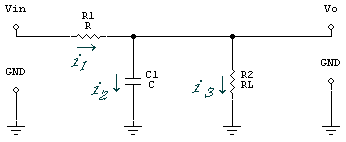

Hopefully this is correct:

Hi again,
It looks like you're on the right track again, but something seems inconsistent when you go to simplify. For example, the first three lines look ok, but then on the fouth line there seems to come in a new variable "R" and the variable "Vin" seems to get left out.
You certainly started out right, so i think all you have to do now is go back over it starting from line three and redo the simplification.
Also, always keep in mind that for any equation with a real part and imag part it will be in the form:
RealPart+ImagPart*j
which simply means that the real part is a group of one set of terms and the imag part is another set all of which were multiplied by 'j'.
For equations that have a denominator, we can always get it into the form:
(RealPart+ImagPart*j)/D
which of course can be broken up into:
RealPart/D+ImagPart*j/D
and if we think of RealPart/D as being RealPartA and ImagPart/D as being ImagPartA, we can rewrite the original equation as:
RealPartA+ImagPartA*j
which means of course that it is back in the simpler complex form:
realpart+imagpart*j
It's just that we would have a denominator also for each part instead of just a numerator when we write it out. This means we can note that when the denominator is real it does not affect whether or not the numerator is real or imag...if it was real it stays real, and if it was imag it stays imag. That's one benefit of making the denominator real when it happens to be complex to start with.
One more quick little note:
If we multiply A+B+C*j times 'j' we have to get A*j+B*j+C*j^2 (and the j^2 can be simplified more) but we dont only multiply the one term C*j times j to get A+B+C*j^2, which would be incorrect. To get the denominator to be real we have to multiply by the conjugate of the denominator.

Alright, hopefully this is correct now:

Hi again Eno.
You're getting closer now. I think all you have to do is be a little more careful when you do your algebraic simplification.
For example, the first line:
Vo/RL=(Vin-Vo)/ZR-Vo*j*w*C
looks good, but then in the second line you left out the "Vo" in the far right hand term and left out the "RL" completely. It might be better for you if you try to simplify one thing at a time instead of two at once. For example, you could first simplify the right side:
Vo/RL=Vin/ZR-Vo/ZR-Vo*j*w*C
and then next simplify the left side:
Vo=RL*Vin/ZR-RL*Vo/ZR-RL*Vo*j*w*C
or even instead first collect terms with "Vo" in them:
Vo/RL+Vo/ZR+Vo*j*w*C=Vin/ZR
and then go from there.
Sound good to you? Give it another shot and this time take care to keep all the terms intact. If you have any doubts, you can at the very least plug random values into your equation before and after, and make sure you get the same exact result. For example, with:
plug in 3 for RL, 4 for Vin, 5 for ZR, 6 for w, and 7 for C, and then calculate what Vo is:

Just some suggestions, and a little mistake correction you don't have that '1' over the denominator:
You don't need to make your denominator pure real, for now (because the phase and magnitude plots are separated), so just keep this one:
[LATEX]V_O = \frac{V_I_N R_L}{(Z_R + R_L + R_L Z_R j \omega C)}[/LATEX]
Use a math gimmick, by calling [LATEX]Z_R + R_L = A[/LATEX] and [LATEX]V_I_NR_L = B[/LATEX]
[LATEX]V_O = \frac{B}{(A + R_L Z_R j \omega C)}[/LATEX]
[LATEX]V_O = \frac{B.(A - R_L Z_R j \omega C)}{(A^2 + R_L^2 Z_R^2 \omega^2 C^2)}[/LATEX]
Magnitude:
[LATEX]V_O.V_O* = \frac{B.(A - R_L Z_R j \omega C)}{(A^2 + R_L^2 Z_R^2 \omega^2 C^2)} * \frac{B.(A + R_L Z_R j \omega C)}{(A^2 + R_L^2 Z_R^2 \omega^2 C^2)}[/LATEX]
[LATEX]|V_O|^2 = \frac{B^2.(A^2 + R_L^2 Z_R^2 \omega^2 C^2)}{(A^2 + R_L^2 Z_R^2 \omega^2 C^2)^2}[/LATEX]
[LATEX]|V_O|^2 = \frac{B^2}{(A^2 + R_L^2 Z_R^2 \omega^2 C^2)}[/LATEX]
Phase:
Another math gimmick: [LATEX] A^2 + R_L^2 Z_R^2 \omega^2 C^2 = D[/LATEX]
[LATEX]V_O = \frac{B.(A - R_L Z_R j \omega C)}{D}[/LATEX]
[LATEX]\Re(V_O) = \frac{BA}{D}[/LATEX]
[LATEX]\Im(V_O) = \frac{- B R_L Z_R \omega C}{D}[/LATEX]
[LATEX]\Phi(V_O) = \arctan(\frac{\Im}{\Re})[/LATEX]
[LATEX]\Phi(V_O) = \arctan(\frac{\frac{- B R_L Z_R \omega C}{D}}{\frac{BA}{D}})[/LATEX]
[LATEX]\Phi(V_O) = \arctan(\frac{- R_L Z_R \omega C}{A})[/LATEX]
If I didn't make any algebra mistake, that is it.

Hi again,
If you take your second line and multiply both sides by RL you dont get your third line. It looks like RL is missing in some of the terms in the third line.
For example:
A=B/C+D+E
if we multiply both sides by C we get:
A*C=B+C*D+C*E
We got rid of the denominator part C but we also have to distribute the C to the other two terms as well.
Take it from the second line and im sure you'll get there this time :)

Sometimes you just need to sketch your transfer function, with 3 base-points, take a look:
For w=0 (DC):
Zc = infinite.
So your Vo = Vin*ZL / (ZR + ZL)
For w=infinite:
Zc = 0.
So your Vo = 0.
For w=fc (-3 dB point with no load):
Zc = Zcfc.
So your Vo =Vin*(Zcfc//ZL) / (ZR + Zcfc//ZL).

Ok, I think this may be it:
[LATEX]V_I_N = \frac{V_O Z_R}{R_L} + V_O + V_O Z_R j \omega C[/LATEX]
[LATEX]V_{IN} R_L = V_O Z_R + V_O R_L + V_O R_L Z_R j \omega C[/LATEX]
[LATEX]V_O = \frac{V_I_N R_L}{Z_R + R_L + R_L Z_R j \omega C}[/LATEX]
[LATEX]V_O = \frac{V_{IN} R_L}{Z_R + R_L + R_L Z_R j \omega C} * \frac{(Z_R + R_L - R_L Z_R j \omega C)}{(Z_R + R_L - R_L Z_R j \omega C)}[/LATEX]
[LATEX]V_O = \frac{V_{IN}R_L Z_R + V_I_N R_L^2 - V_{IN} R_L^2 Z_R j \omega C}{Z_R^2 + 2Z_R R_L + R_L^2 + R_L^2 Z_R^2 \omega^2 C^2}[/LATEX]
[LATEX]Real = \frac{V_{IN} R_L Z_R + V_{IN} R_L^2}{Z_R^2 + 2Z_R R_L + R_L^2 + R_L^2 Z_R^2 \omega^2 C^2}[/LATEX]
[LATEX]Imaginary = - \frac{V_{IN} R_L^2 Z_R \omega C}{Z_R^2 + 2Z_R R_L + R_L^2 + R_L^2 Z_R^2 \omega^2 C^2}[/LATEX]
[LATEX]Amplitude = \sqrt{(\frac{V_{I_N} R_L Z_R + V_{IN} R_L^2}{Z_R^2 + 2Z_R R_L + R_L^2 + R_L^2 Z_R^2 \omega^2 C^2})^2 + (- \frac{V_{IN} R_L^2 Z_R \omega C}{Z_R^2 + 2Z_R R_L + R_L^2 + R_L^2 Z_R^2 \omega^2 C^2})^2}[/LATEX]
[LATEX]Amplitude = \sqrt{(\frac{V_{IN}^2 R_L^2 Z_R^2 + V_{IN}^2 R_L^4 + V_{IN}^2 R_L^2 Z_R^2 \omega^2 C^2}{(Z_R^2 + 2Z_R R_L + R_L^2 + R_L^2 Z_R^2 \omega^2 C^2)^2})}[/LATEX]
[LATEX]Amplitude = \sqrt{\frac{V_{IN}^2 R_L^2(Z_R^2 + R_L^2 + Z_R^2 \omega^2 C^2)}{(Z_R^2 + 2Z_R R_L + R_L^2 + R_L^2 Z_R^2 \omega^2 C^2)^2}}[/LATEX]
I don't think I can simplify it anymore? I could, however, if I didn't have the [LATEX]2Z_R[/LATEX] term.
Edit: I tried graphing the filter, and it produces one that starts at 25V, while [LATEX]V_{IN} = 5V[/LATEX].

Hi again,
You're getting closer now. Just a simple error in line 5, the denominator is not quite correct, but it's close.
