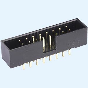

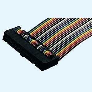

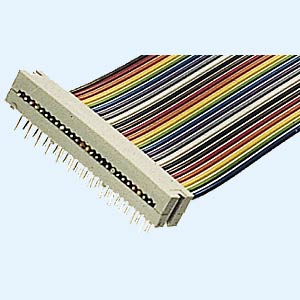

Hi MrDEB,
I don't know what your trouble is.
Use a box header (two rows per 5 pins) and the suitable female connector.
The female connector contacts the wires trough the isolation when you use a bench vise (or appropriate tool).
Take a look inside your PC where this kind of connector is used for IDE-devices (HDDs and CD-ROMs)
Boncuk
P.S. The first connector is meant to be soldered directly on the PCB, the third plugs onto the box header.

the pcs that Boncuk posted are what I am looking for.
really not sure what the actual name of them so locating is ???

Those connectors are called IDC [ insulation displacement connectors]
They have a bi-furcated slot/notch for each cable wire, as the wire is forced into the slot/notch it cuts thru the outer insulation of the wire and makes contact with the copper conductor.
ie: insulation displacement
They are designed for 0.05inch pitch ribbon cables.
They can be assembled by using a small bench vice to force the ribbon and IDC slots together.
