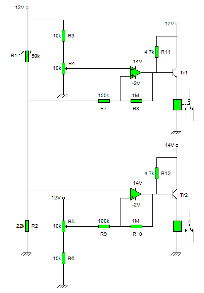

Here's how I would do it.
Obviously I'd change the resistors to suit the resistance of the thermistor.

Hero, I appreciate the diagram you drew, and am trying to understand it thoroughly. Why are there two rheostats in there? And also, where do you get +14 and -2V from? I mean how would I generate that off a 12V power supply?

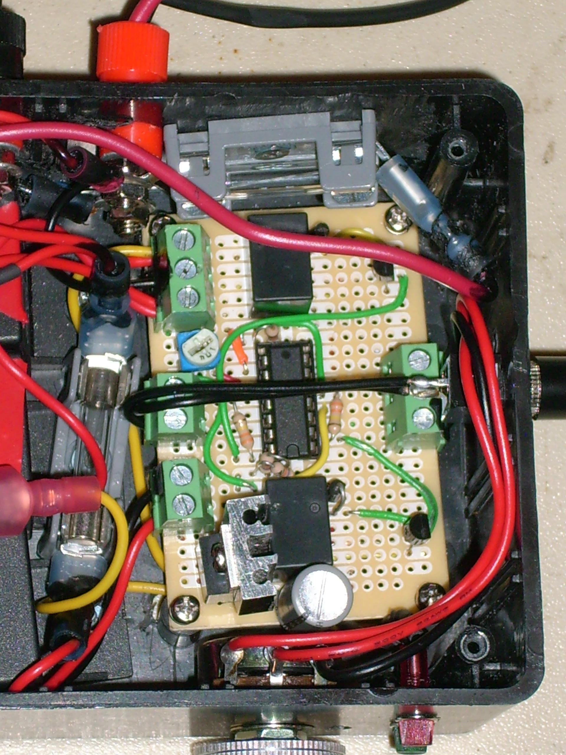

Soo guys I ran one more test. It turns out that this severe "humming" of the relays goes away if I connect the +12V source of the heavy 30A automotive relays via BEOFRE the voltage regulator and filter capacitor (180uf).... Could that have been the real and only source of the trouble???
Thank you everyone! All your advice has helped me! The info on the comparators, Hero's new circuit diagram from which I took info, the links, and all the suggestions everybody gave.

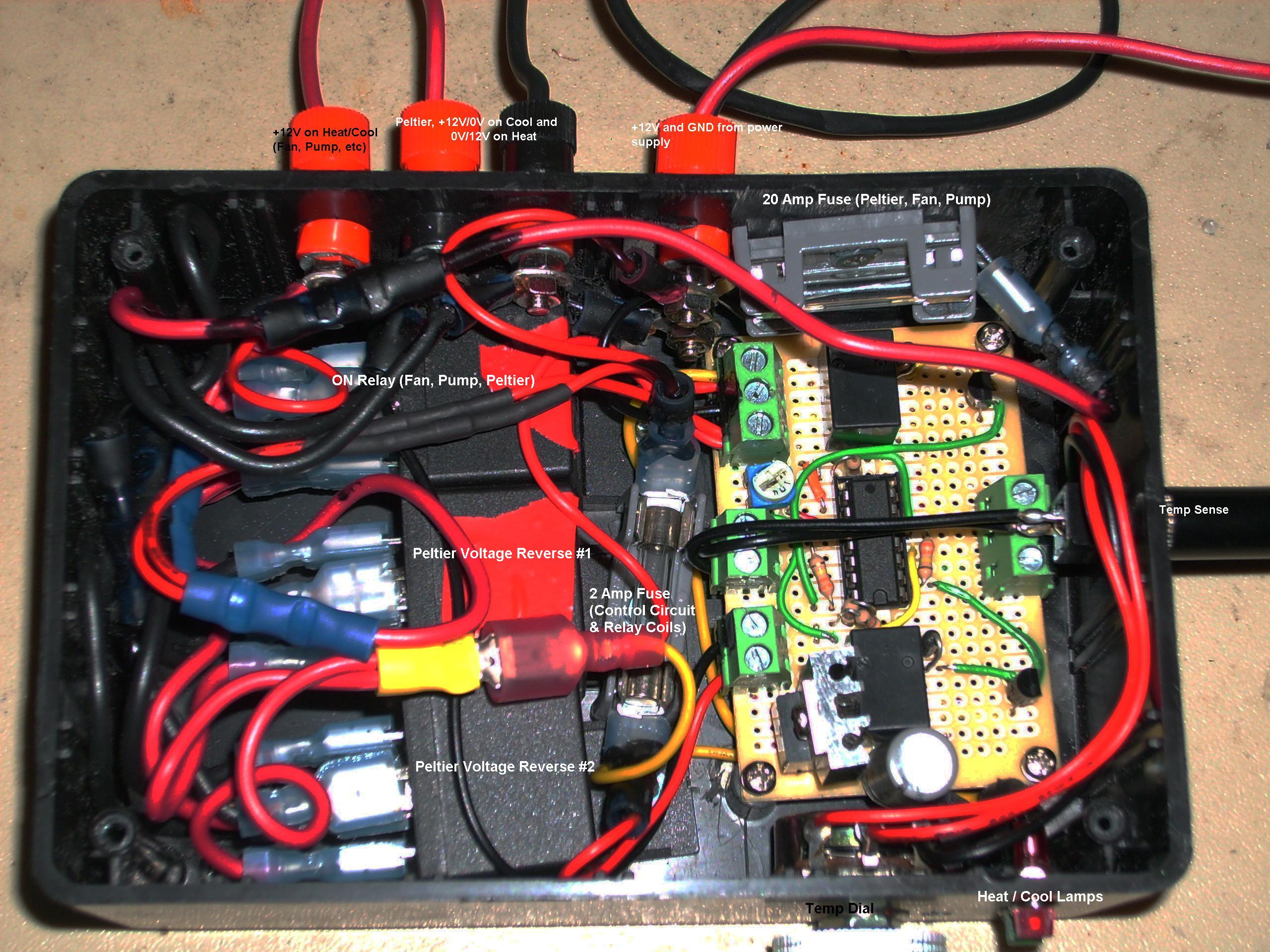

As a little gratitude I attached two pictures of the project.
One showing the whole project with labels and the other one the circuit board in detail (it has a lot of connections and some resistors on the bottom too which can't be seen from above)
Let me know what you think!
Thank you so much again!
EDIT: Now I just have to figure out how to keep the peltier from condensing because in heat mode when the heatsink gets too cold it "shortens out" and creates weird electronic humming again and when I dry it off that stops, but I'm sure that's something I'll figure out. Researching right now : )
One adjusts the high temperature and the other adjusts the low temperature.
Just ignore it.
I use some kid's simulation software (Crocodile Clips) for simple circuits like this and the only model it has is for the 741 which has a saturation loss of 2V on either supply. To get round this, I simply add 2V on to the + rail and take 2V off the - rail. I normally change the rails back to 0V and 12V before posting but this time I forgot.:eek:
