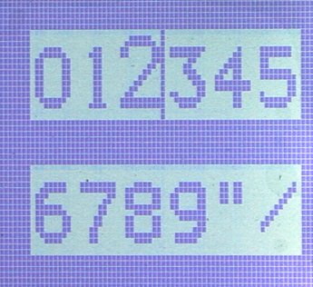

I tested RB's font set, and it is too big for me. I need 6 characters on half of the screen (64 columns wide). So I made an 8x11 character set and used rotates to calculate offsets for a look-up table. I had to insert a blank column to separate characters during the print process. Yesterday, thanks to the flood, I played with a character display program that would allow unlimited character widths and did not use rotates. I am attaching the heart of it here. The bitmap table is separate from the logic.
The characters shown, except the "2" are 8x11. There are two versions of 6 and 9. The 6 is a little more rounded. Anyone want to give a preference?
The "2" is 9x13. Now that I have done a whole set of bit maps, it is really not that hard. However, if someone has a really good programfor doing it on a PC, I would like to hear about it. Graph paper and pencil work, but are a little tedious.

I edit pixels in a graphics (paint type) program, after zooming right in to max zoom so the pixels are about 1/4" each in size. My graphics program puts a square box around each pixel when at max zoom, making it easy to count white pixels etc.
Re your characters, it's good to stick to conventions. For instance, your 1 has only a single row of pixels on the bottom bar, all other characters have two rows of pixels on the horiz bars. Also, the diagonal lines on your 7,4,3 look good with only two pixels width. But your 6 and 9 have a 3 pixel wide diagonal, making them look blocky. I would fix that and also make the loose ends of the 6 and 9 more curved for improved recognition. And your 5 has a single pixel in the bottom curve, it would look better I think if more like your 3, or at least make the bottom curves on the 3,5,and 9 all match. :)
Thanks for the suggestions. I will incorporate them in the characters shown here and in the 9x14 set I am working on. That set may end up 9x13, but I will probably stay with the original, smaller "big" numbers.
As for designing fonts, I found the Mikr...(common program, don't have link here) GLCD font design program. It allows one to expand the design to any size on screen, click to darken pixels, rt. click to clear, and some other manipulations, such as mirroring. Printing function is very limited, so I print screen, then use Photoshop to get the design. I still need to convert the bitmaps to hex manually, but that is not too hard -- just boring.
