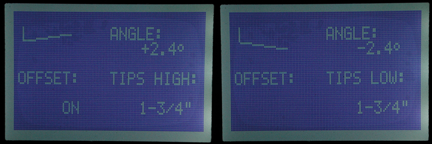

Update#2
Just thought I would add a screen shot of the GLCD taken with mock accelerometer data (see: my blog, Memsic).
The "ON" for OFFSET blinks. One snapshot missed it. I made it blink, as having a few degrees of offset and not realizing it, could create problems. The wiggle line is an icon with 4 positions, l evel, +/- 1, +/- 2, and +/- 3 as a graphic indicator of tilt. I may eliminate it in the final version.
Right now, I am looking for bitmaps for double-size numbers, i.e., 10X16, that will be easier to read. Anybody have that or know of a good link? Presumably, the lines will be two-pixels or more wide.
