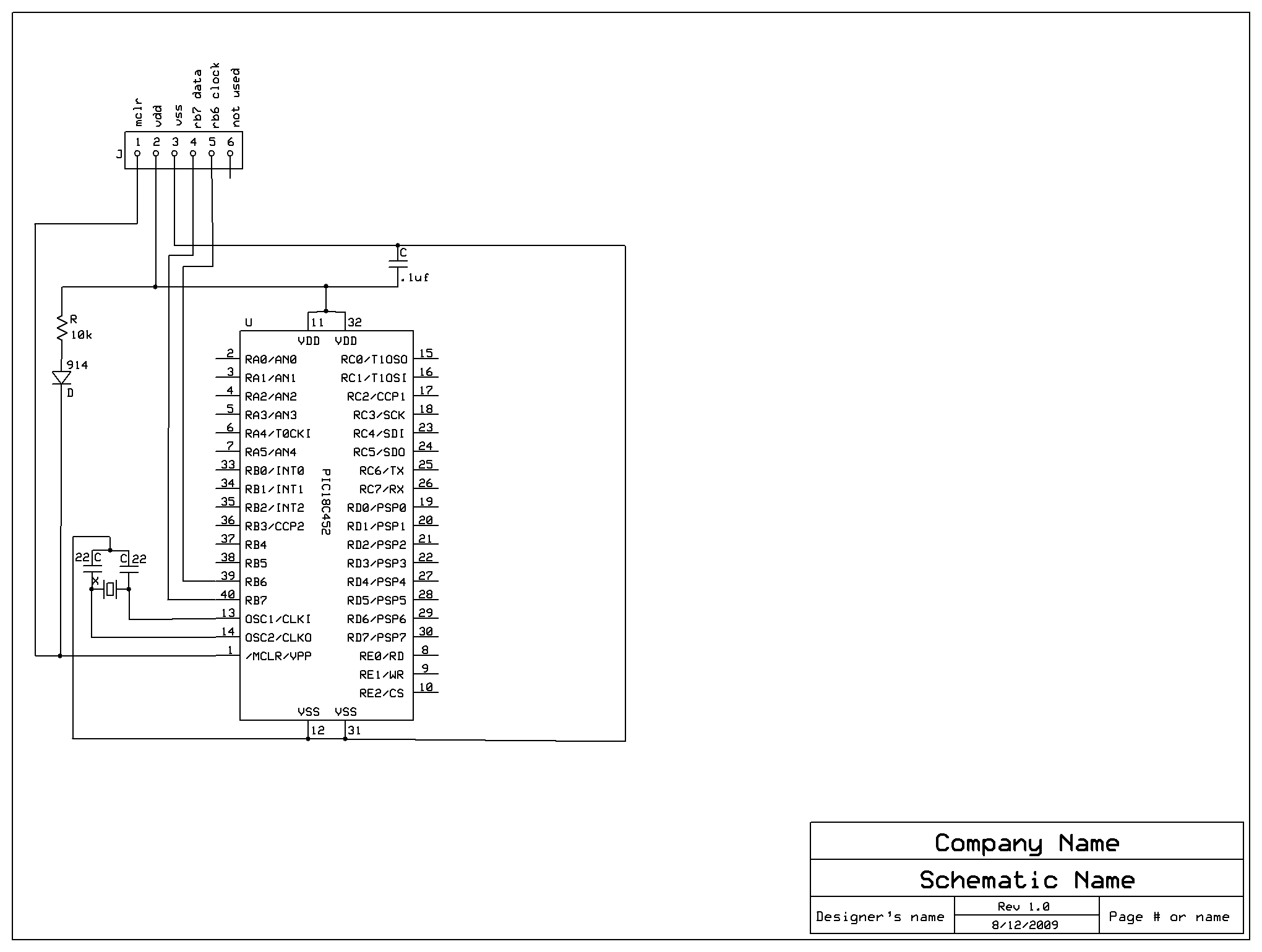

You can plug in any chip thats a pdip here a 18f452
you only use 5 wires to program
the connection photo that be80be is showing uses only 5 wires.
the plug has 10 pins but only 5 are actually used.
just be sure to get the socket inserted correctly (the ribbon cable has a red indicator for pin one.
I recall the junebug comes with the plug for the ribbon cable as well as a ribbon cable.

be80be, do you mind giving me some sort of circuit diagram or rough sketch so that i know wht pins of the 18f452 to connect to the junebug board...
so basically when i connect the 18f452 to the junebug board i can program the 18f452 as usual???do i remove the other PICs on the junebug board?or keep them?

Here all you need to start with. Set your chip up like this
