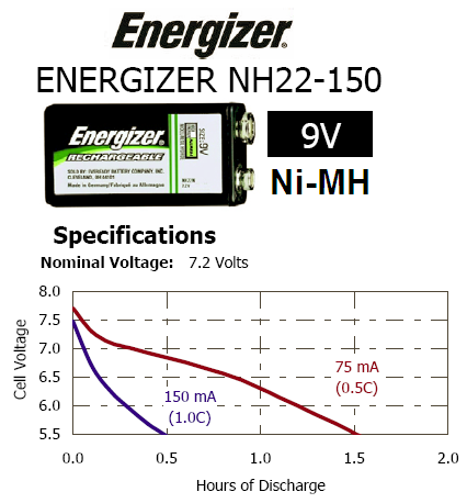

If its low current then consider running it off a rechargable 9v battery. It will give you a steady voltage until near the end of its charge.
You don't want the 7805 regulator to operate in dropout. Then it is already not regulating and its output voltage has already begun to drop.
A rechargable 9V battery can supply hardly any current.
Its voltage drops like a rock if the current is more than about only 10mA.
Sometimes it doesn't matter, suppose a circuit will work from 4 to 5V so providing it doesn't drop below 4V it'll be alright.
I agree but 7.2V batteries are crap, you want 8.4V.
The 6 cells in a "9V" battery rated for 7.2V are bigger and have a higher capacity than the tiny 7 cells in a "9V" battery rated for 8.4V.
The voltage drops quicker when the battery's capacity is less.
That's true, I suppose it depends on the current draw and the minimum voltage requirements of the circuit.. I have as multimeter that won't even work properly at 7.2V, it displays the low battery symbol which isn't any good when run of a 7.2V battery.
A 9V alkaline battery works for years in my Fluke multimeter.
My cheap Chinese multimeter also works for a long time on a 9V alkaline battery but it doesn't automatically turn itself off. I must remember to turn it off.
