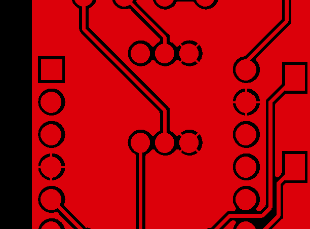

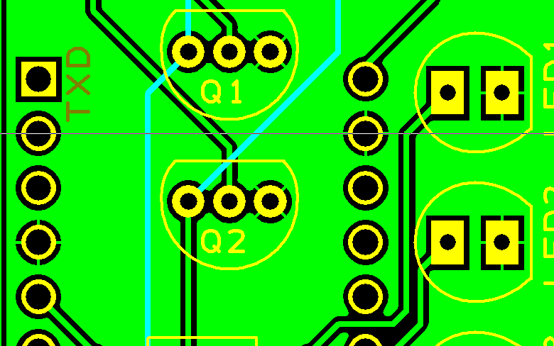

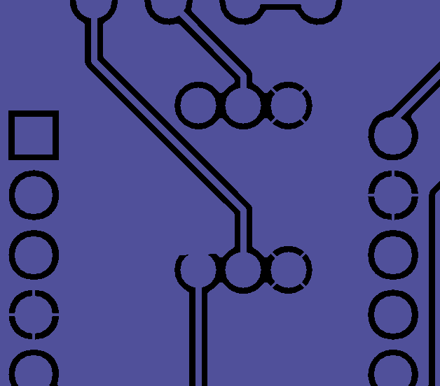

After a long absence from electronics I thought I tried some "easier" projects.
Some deliberation later I settled on the nice looking packet by DesignSpark for my schematic/PCB design. So far fairly happy.
Problem; when I look at my pcb in Gerbv I get 1 pad that doesn't look right (see attached image)
when looking at the PCB in the Designspark Software it looks ok and it looks ok when looked at it with an online viewer (https://www.gerber-viewer.com/)
Designspark
Online Viewer
Gerbv
Which one should I trust now?
It may just be a resolution issue. There just aren't enough pixels to render the pads correctly.
You could upload the files to FreeDFM.com, a service provided by Advanced Circuits. This free service hs been good at finding problems.
when looking at the PCB in the Designspark Software it looks ok and it looks ok when looked at it with an online viewer (https://www.gerber-viewer.com/) View attachment 113258Designspark View attachment 113259Online Viewer View attachment 113260Gerbv

Yeah, when I change the rendering in Gerbv to Fast, it comes out OK. So the resolution thing makes sense? It just shows that double checking always pays off! :)
I will have a look into DFMnow, this looks like a promising replacement for Gerbv.
