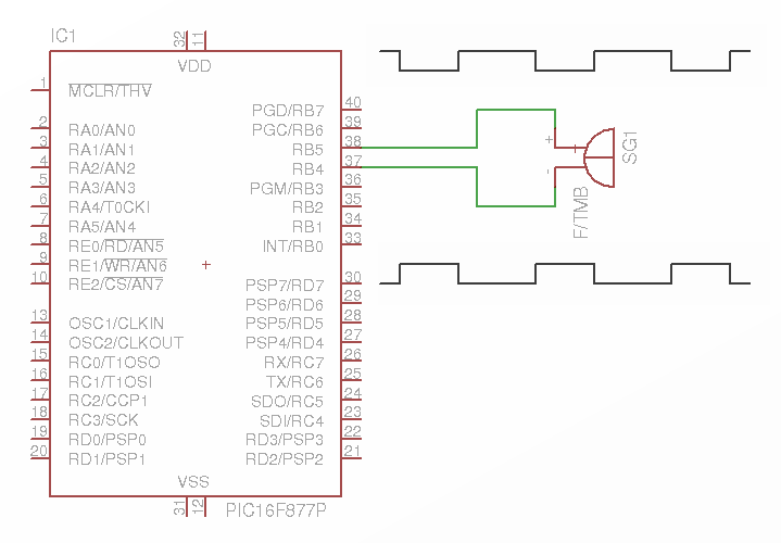

i want to ask a question depending on the above code and the circuit connection "which i'll send later", is the output for the ultrasound transmitter sensor will be like the foolowing the circuit i send.
plz anyone check and tell me ?
thank u for ur help
thank u for ur help

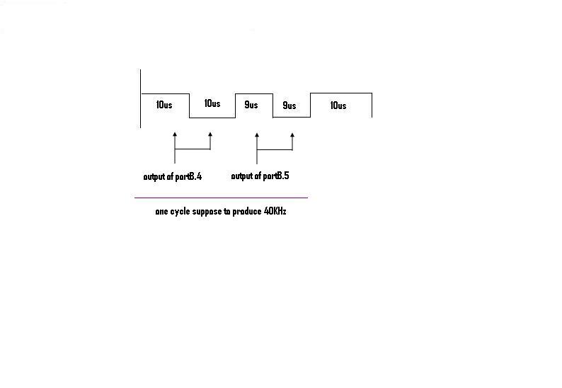

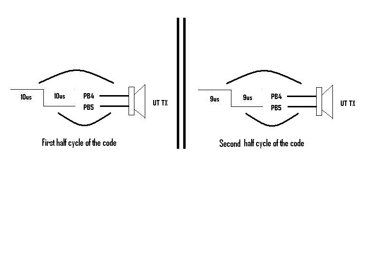

No, that's not what comes out. The signals aren't end-to-end, they are being driven against each other. The way I would think of it is more like this:
draft1-png.21587
I don't know if that makes more sense but it's clearer to me. Note that the timings are greatly exaggerated in this drawing. :)
Torben

No it's not, the original way is a bridged connection, this doubles the voltage supplied to the transducer, quadrupling it's output power.
