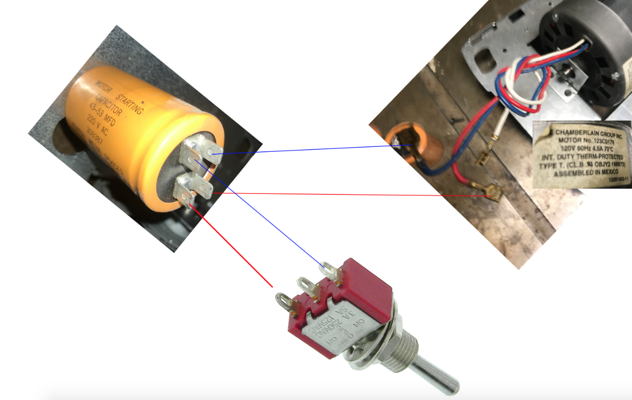

I understand everything on the diagram except for the capacitor. Is that inline between the fuse and center pole of the center-off switch?

No. The motor has three terminals, as Mikes post (from 6th July 2009!) shows. The capacitor is permanently connected between the red and blue wires. The neutral of the mains is permanently connected to the white wire.
To make the motor go one way, the live of the mains is connected to the red wire, with the blue wire getting power via the capacitor.
To make the motor go the other way, the live of the mains is connected to the blue wire, with the red wire getting power via the capacitor.
It's the standard circuit for a capacitor-run motor.

Ok, I just realized that the capacitor is indicated between the switch and the motor in the diagram.
The capacitor that came with the garage door has two terminals. Each terminal has two blades.
Do the red and blue wires go on opposite terminals or opposite blades of the same terminal?
Assuming a fuse and AC L1 go to the center pole of the switch, and the motor white wire connects to AC neutral... is this correct wiring for the capacitor?

Yes, that's correct.
The two blades on one terminal are for wiring convenience only. They are clearly connected together and you can use one or both, whichever makes connecting it easier. The circuit diagram will not usually show them as separate.

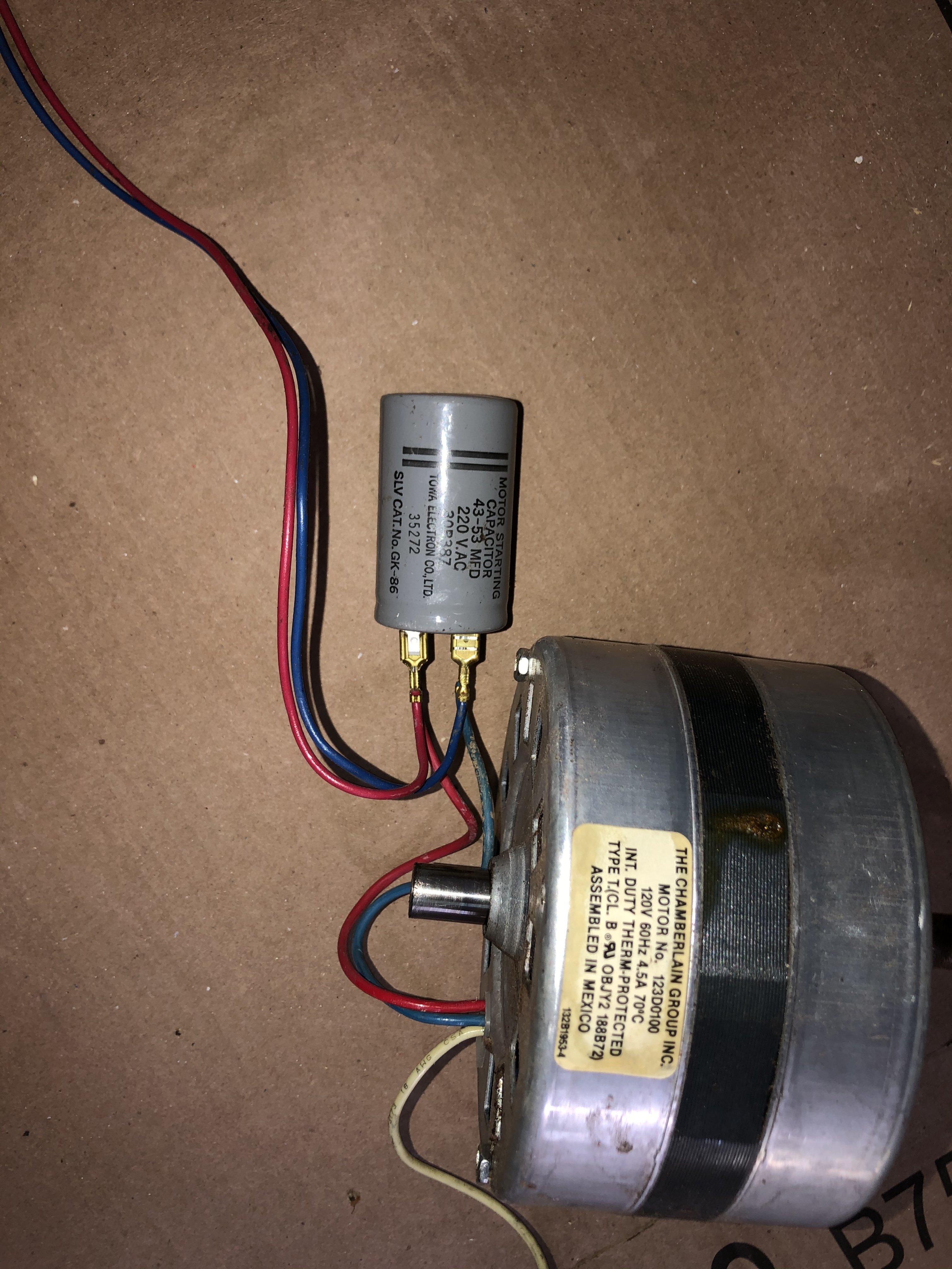

Here is an image of my motor and capacitor.
What I need is 60RPM (max) out. The standard motors that run this kind of mill alter 1/9Hp. This one is, I believe, 1/3Hp.
That is a standard (Chamberlain) garage door motor, it is PSC (permanent start cap motor) each winding is identical and either used for start winding/direction.
Switch L1 to either R or S for direction.
It show 43 to 53 uf, ensure you get motor run rated cap.
