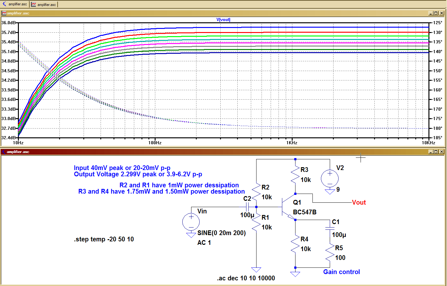

Gain of a single stage transistor amplifier with a emitter bypass capacitor is [AC] frequency dependent.
Look at the lower frequency roll off point on a 'AC Analysis' plot,

If i am wright Roll off is in 9.7Hz , where is temp. Directive here ?

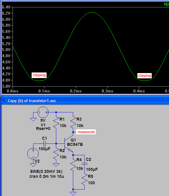

Your transistor is biased wrong which is causing its output to clip. Its base voltage is too high which causes the emitter voltage to be too high. then its collector cannot swing lower than +4V. The value of the emitter resistor is also much too high.
Here is my simulation of your circuit:

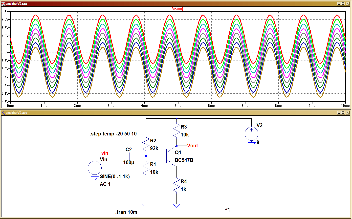

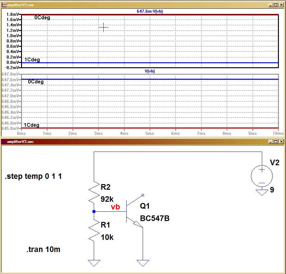

Look at this simple amp, showing use of the Temp Directive.
EDIT:
Added your circuit, change the Analysis parameters and added Temp
wow , it shows multiple graphs, what are these multiple graphs showing ?
You should be able to explain what the multiple plots represent.
What do you think.?
EDIT:
Hint: Look at this image

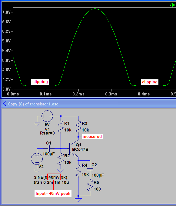

In your last simulation, you show 20mV input but the text reads 40mV peak. I didn't read your text so I showed an input of 20mV peak on my simulation that was clipping a little.
Here is my simulation with a 40mV input and its output is clipping a lot because the transistor is not biased correctly:
