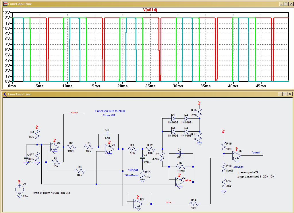

To get a variable mark/space ratio square wave, just add a another stage, as shown in this image.
Using a 25K pot you can change the ratio without changing the frequency.

U4 is configured as a comparator.
One input is the 'triangle waveform', the other input is a 'dc' voltage set by R18 the 25Kpot.
As the pot is adjusted the comparator threshold switch over point is changed, so the output switches over at a different level of the triangle wave.
This changes the output signal mark/space ratio, which is the output you require .

Your modification does work just right, Thanks for it,
I did not add R12, R13 And C3 because they caused the sine wave to be changed to a triangle at the output of U2 when simulating.

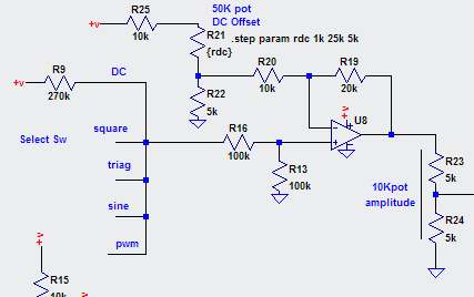

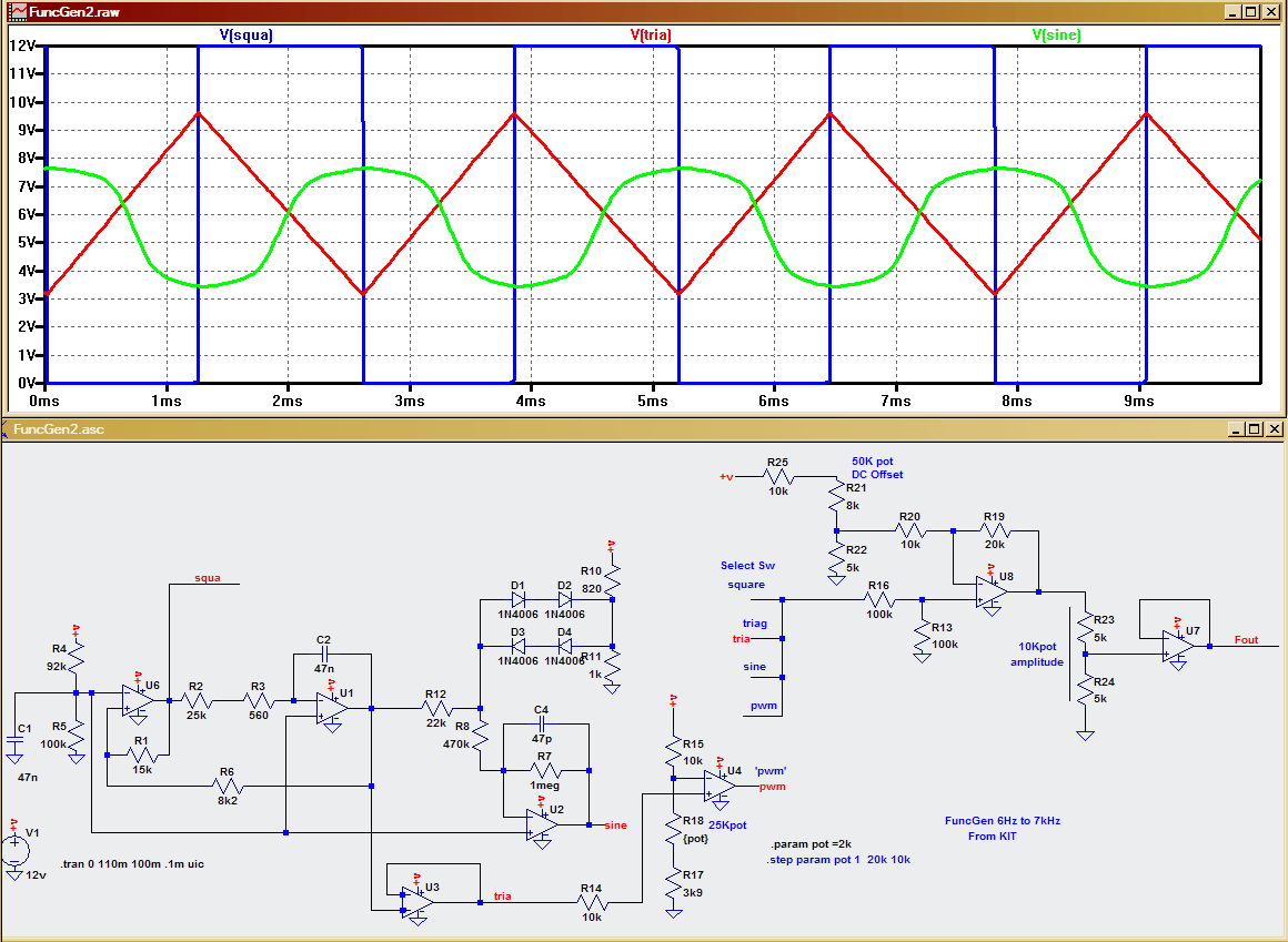

Look at this simple option.
Use a 4 position switch to Select the input from the waveforms into the U8 opa.
There are two control pots R21 which is DC offset and R23/24 which is output amplitude
U7 opa is optional, but I would fit it as it will give a 'low' output impedance for the selected signal.
NOTE: the 'raw' sqr, tri, sine and pwm waveforms will still be available for use.
Use the U7 output for your special projects where you need to change the DC offset and amplitude.

Use the 82K.
You could get a DC output as you suggest, just leave the input to R16 open circuit, on say a 5th switch position.
Eric,
I Simulated your last modification by Proteus software, Unfortunately I was not able to change the DC OFFSET by changing R21 Value??! when I tried to change its value the amplitude changed and I have no good result to change DC OFFSET by R21?!! Any idea? I don't know the reason but Am thinking on an OP-amp Summer to sum DC with Those waveforms?
DO you have any idea why your mode's behavior is so??! Can you explain me What is the U8 circuitry by your kind??

Its because of the DC offset present on the sine/tria/square, is not present when the Select switch is open circuit.
Just add a 220K or 270k resistor from the DC position of the Select switch to +V.
As shown in this image

I do not understand your meaning by this ""Its because of the DC offset present on the sine/tria/square, is not present when the Select switch is open circuit.
As you can see from the earlier waveform plots, they swing about 6V, not 0V, so there is always a 6V or so DC offset.
From your earlier post I thought you were saying that the DC didnt work when the DC position was Selected, I must have misunderstood.
My Switch is always connected to one output of the waveforms and to the noniverting input of U8 via 100k resistor as shown in your modification.Actually I don't know why You added R9 in the circuit?
As my note above said, I thought that you had a problem with DC offset Select, thats why I added R9.
Can I experience 0 OFFSET by changing R21, and whats the Max of OFFSET I can expect by changing it?
R21 is a 50K variable, so that you can set the DC output offset.
Thanks like alway.
I think we had our wires crossed a little...:)
If you build the circuit as shown in FuncGen2a image, it will work, try varying R21.
EDIT:
Post the images of the waveforms on the Vout on your simulation.
