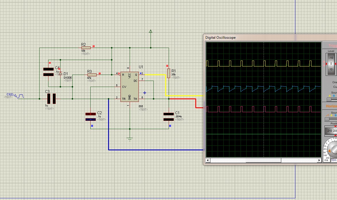

Ian, If I understand your schematic which gives me the idea , inspite of many polarity errors,
the trigger, as I read is Vcc/3 on pin2 , yet C5/C6 are equal so the pulse starts at Vcc and gets divided in half and never reaches Vcc/3
So C5 must be much smaller than C6. Make C6 bigger or C5 smaller.

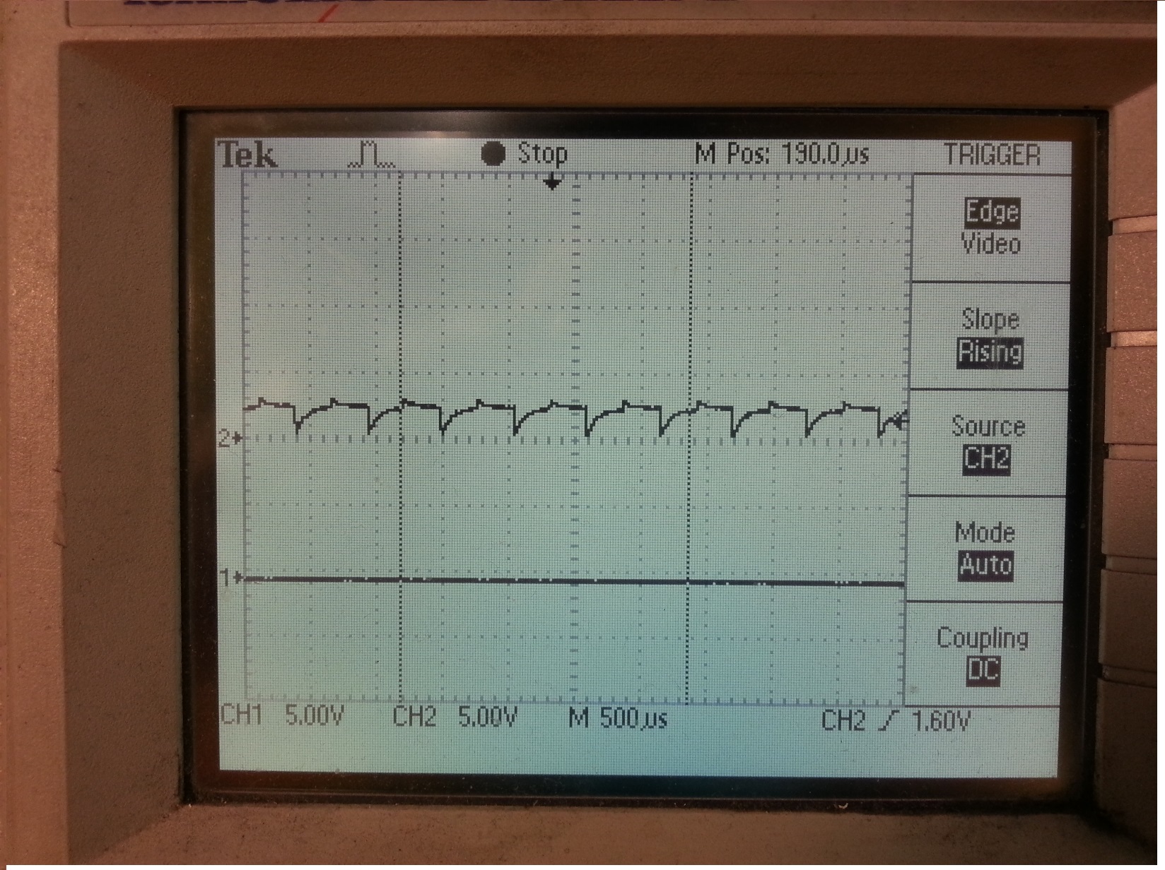

Right!!! It wasn't the LT555C.... but now I have a pretty good trigger waveform....
It would appear that something else is causing the 555 to have no output... Still!! If I manually trigger it, it has an output!!!....
ericgibbs ..... What should I be seeing on the Threshold / Discharge pins whilst acting as a monostable... I only get 0v... permanently.. Reset is high and cv is tied to a decoupling cap.... When simulating the output mimics pins 6 and 7...
This maybe where the fault lies..... I have 35k resistance to 2.5v but I cannot determine which cap is to ground.... If I don't get a pulse on pin 6 and 7, I'm not going to get a pulse on pin 3... BUT!! shorting pin 2 to ground fires pin 3.... I dont get it... The pulse looks good enough to trigger the 555????
Here is the simulation.....

The second trace is on pin 3...
If you had a variety of fixed resistors to drop the trigger DC voltage, what is the largest value that forces a trigger? Then you can see if the device current is faulty.

My take.... There must have been something wrong with the 555 as the signal on the trigger is 10 fold... Therefore there must be something wrong elsewhere... I figure a possible short on the threshold cap holding the pin low...

I see the time constant of the trigger components in your post #30 sim is much greater than the time constant of the output pulse. Could that be the root of your problem in the real circuit? C3 needs enough time to recover from one trigger before getting the next trigger.
