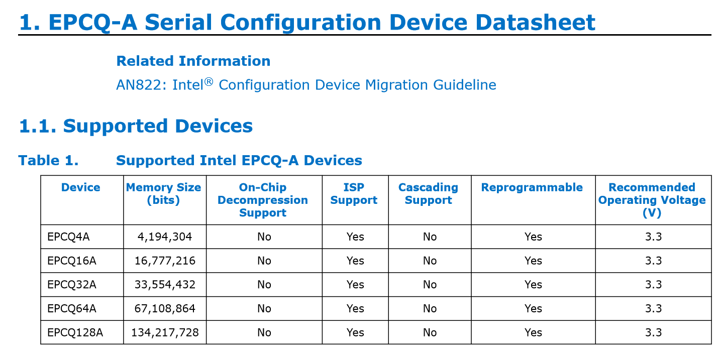

data sheet
These are large memories for being in a 8 pin package.
