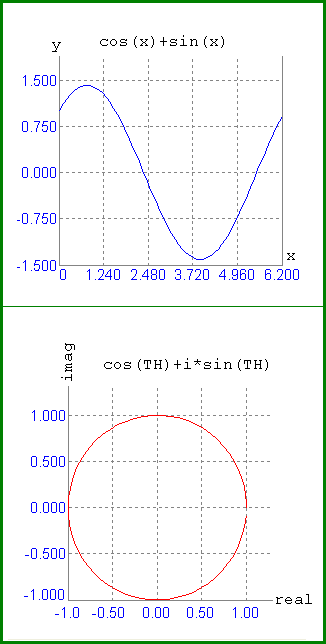

Hi again,
I wasnt sure if this was clear enough so i went ahead and graphed both of those functions for you. See the attachment.
Note the red plot is not closed because i only ran Theta (TH) from 0 to 6.2 instead of from 0 to 2*pi (6.283...) to show where the start of the plot is and where the end of the plot is.
Clearly the top plot cos(x)+sin(x) is just a phase shifted sinusoidal wave. To produce this plot each value of cos(x) is simply added to each value of sin(x) for every x from 0 to 6.2 .
Clearly the bottom plot cos(TH)+i*sin(TH) is a circle, where the x coordinate is obtained from cos(TH) and the y coordinate is obtained from sin(TH). Note this is not a simple addition of the two terms as the above plot, but a two dimensional parametric representation.

You have ploted Cosx , iSinx in complex plain. but you have not added them , but lets leave it i asked iSinx graph in X,Y plane , obviously it cannot be ploted because it is imaginary.
and also Cosx + Sinx can be plotted on Complex Graph but it would be one dimension, There value would only be on Real axis.
so when a Simple time domain signal is coming it can be easily plotted in both X,Y plain, But would become 1 dimensional signal in Complex plain , it would keep on Varying on real Axis. So what it all has to do wiyh phase ?
cos x and i sin x do not add directly. How many times do you have to hear this before you actually sit down and try an example? That's how you start to understand why and how this works. You can add cos x and sin x, but you cant add cos x and i sin x. That's because cos x is the real part and sin x is the imaginary part, and you do not add a+bj directly because a is real and b is imaginary. This is where the phase shift comes into play. Because we have two numbers rather than one, we can say that there is a phase shift and an amplitude rather than saying that there is a real and imag part.

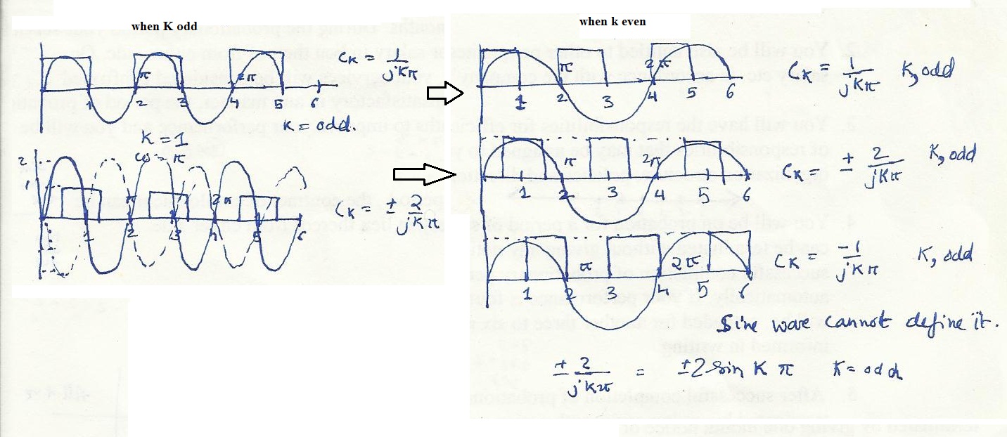

Ok i have managed to know Fourier series from all this discussion.
and i posted a little pic for you to see my inference from it.
(Please message me if you cant see image rathere then posting here)
But i still dont understand Fourier Transform, why is it different from fourier series.
Wikipidea is not helping me in it..
(If possible please explain me with drawings):)
what i understand from Fourier series is there is nothing as phase of signal.
signals are defined by Cos wave or Sine wave, you cant add both of them therefore they write both of these in Complex form.

I can see your drawing now. Im not sure what you mean by "Sine wave can not define it".
I gave you the solution to one part of the expression, cant you take it from there and do the others the same way? If not i'll give more info.
If you can not tell the difference between the Fourier Series and Fourier Transform that's probably because you've so far only looked at periodic signals. To get more insight into this, try to find the Fourier Series of the SINGLE unit impulse located at t=t0 (this is a one time only impulse that does NOT repeat). This signal looks like this:
______|____ (and that impulse is located at t=t0 and never repeats)
To see how the phase comes into play, i'll post more if you still dont see it yet.
