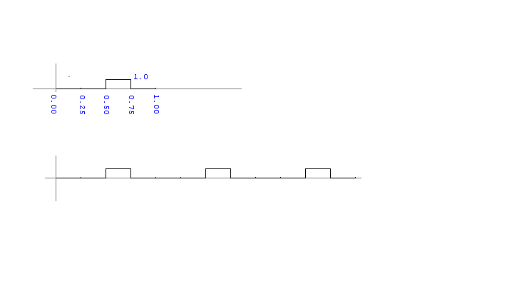

Well, you've talked in very general terms there so what you need to do is start to work some actual problems.
For example, take a pulse and calculate it's ck for say 11 ac components (and 1 dc component) and then try to reconstruct the original signal. If you can program in any language you can set this up inside a program and reconstruct the signal using say 111 ac components or even 1111 components for that matter as the program can calculate these in less than a second.
For an example pulse, say we have the following:
The pulse amplitude is 1 unit high. The pulse starts at t=0.5 seconds and ends at t=0.75 seconds. It repeats every 1 seconds (period=1). Calculate the ck for N components and then use that data to reconstruct the pulse signal. To get the right output you either have to use sines and cosines together or you can use a cosine and a phase shift or possibly even a sine and a phase shift.
Using 0.05 second intervals the pulse amplitudes would look something like this: 00000000001111100000
where that whole time period repeats and the period is 1 second (see attachment).
This kind of example shows how important it is to have the extra information given by the phase shift when we're using only one sinusoidal or cosinusoidal representation instead of both.
So we either have:
y=A*sin(wt)+B*cos(wt)
or we have:
y=C*cos(wt+ph)
where ph is the phase shift.
This is not too hard to see if we think about what it takes to make the wave: A*sin(wt)+B*cos(wt) with only a single 'soid, like cosine. The sin and cos terms when added create just another sine shaped wave but it has a phase shift along with it.
The attachment shows a single period of the pulse and also what it looks like as it repeats over and over. The pulse amplitude is 1.0 high.
