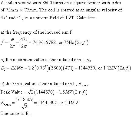

Hi:
Do I have to upload images in order to embed them here?
Anyway. Please see my question attached to the image.
Thank you

How do I delete the original from the edited post.
And are my answers to the questions correct?

You can't delete the thumnail (assuming that's what you're talking about).
The frequency calculation is certainly right. I'm not sure about the voltage because I've not done this kind of thing for a long time.
Why have you calculated the RMS voltage, then the peak and converted it back to RMS?
Surely this adds more error into the calculation with no benefit?
I'd be tempted to repeat my previous answer but maybe you've made a mistake and the previous formula gives the peak voltage? Sorry I can't help you perhaps you could try Wikipedia?
