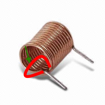

You can also change the frequency by changing the coil. This kind has a "slug" that turns and moves in/out to change the value.
Another way to change the frequency is to separate the wires a little in the coil. In the picture I tried to show pulling one turn out a little. If you bend one turn 90 degrees it is almost like removing it.

Waow. Here is home. I'm learning a lot. Thanks
