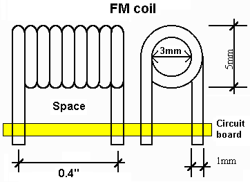

i measured inductance of the coil given by audioguru using inductance calculator .link is
Air Core Inductor Coil Inductance Calculator but it gives inductance value of .19764 uH.
Will it be okay?
Why not simply make the coils like I show? I used 1mm enamelled copper wire tightly wrapped around a 3mm drill bit. use 8 to 10 turns of wire. space the coils away from the circuit board about 3mm.
