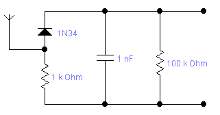

Can this be used as a field strength meter? I've seen one, the coil is connected where the 1k:eek:hm: is. The multimeter should be set in AC mode or DC mode?

I took apart my Field Strength Meter. I forgot it needs a small input capacitor to block mains hum and AM redio stations. Also the 1st resistor is 10k.
Its output is DC or AM modulation.

What is the frequency range of this meter? Only in FM range? Why it doesn't need to be tuned to the right frequency?
What I need to do is just put the meter next to the transmitter and measure right? Otherwise the value I see will be the strong signal from FM station.
Can this meter measure the reception of the receiver? I think no.
It works up to about 250MHz.
It shows the strongest level of any high frequency signal near it. You don't need to tune it.
Mine was 1m from my transmitter.
The circuit is just a rectifier without any gain so it shouldn't pickup radio stations unless they are very closeby.
Even it is simple, the capacitance in the breadboard can affect the measurement right? I think I'll make a PCB.
Thanks a lot :)
A breadboard shouldn't be used for frequencies above zero Hz.
It is OK for small DC motors and small light bulbs.
