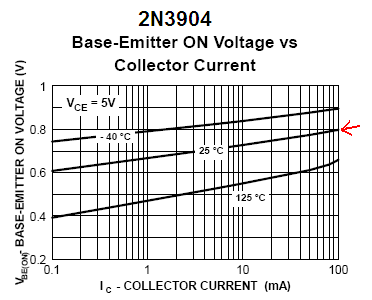

I've connected a short wire next to the antenna, it can transmit further with the probe touching it.
The base and emitter of a transistor is a low current diode. A low current diode never has a forward voltage more than about 1V. Yours has 4V and is probably broken.
Oh, thanks. Maybe be junction is opened circuit, the 4 volts maybe from somewhere else? But there shouldn't have any current at the emitter right? I'll replace the transistor and check all the connection again. Maybe there is one or more wrong connection.
Of course there should be emitter current, the transistor should be conducting about 28mA from collector to emitter. The emitter should be about +1.57V and the base should be +2.33V. If you didn't have your 56 ohm emitter resistor then the collector to emitter current would be about 35mA and the base would be about +0.77V.
