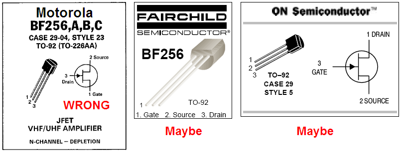

is it the problem of the bf256 transistor? Is there any transistor can be used beside this?
From Google, I found that the pins representative for bf256 are different.
Some showed the pin: Gate, Source and Drain
but some gave me: Drain, Source and Gate
but I've tried both, gave the same thing.
What should I do? :(
The manufacturers of the BF256 got the pins mixed up. It is easy to use an ohm-meter to find the gate. The gate is the anode of a diode to the source and to the drain. It is difficult to measure which pin is the source or the drain.
The voltage at the source should be a couple of volts DC.
Try a different numbered FET.

Yes, I found that too. #1 definately wrong. But I've tried both #2 and #3.
The website said that, if the circuit is not working (no sound exactly), I may need to change R4 to 20K (up to 50K). Besides 2N4416, J310 and MPF102 are recomended. Hopefully I can find either.

Then the FET is not doing anything. It should be conducting and creating about 2V actross R4. The pins might still be mixed up.
Oh no, both GSD and DSG gave me the same result. Should I try SGD or DGS? That is troublesome, I have to change their location..
*G=Gate, D=Drain and S=Source
Try every combination of pins for the FET until it draws some current and starts working.
Now I can hear some buzzy sound. I was using enamel coated wire as jumper! That's why they were not functioning and I couldn't hear anything! I've measured the voltage across R4, it is around 3 volts with analog multimeter. With the FET's pin is GSD. I've tuned the trimmer capacitor, but I can hear only buzzy sound.
