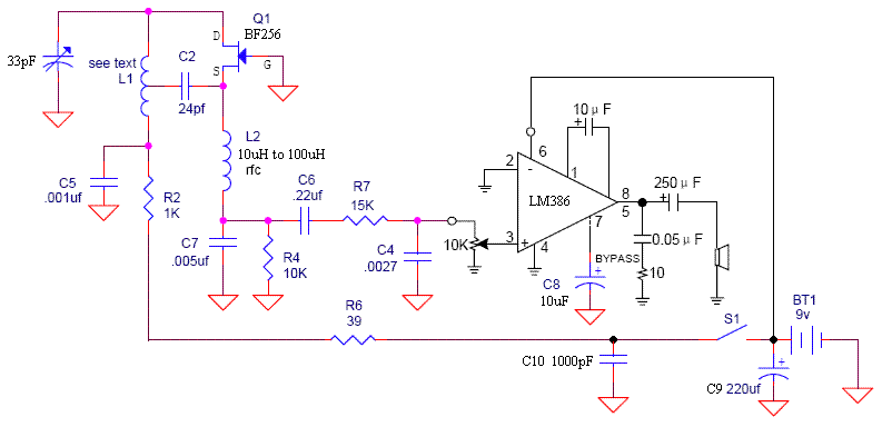

I've just modified the circuit, but I'm not sure whether correct or not.
1. I use only a 33pF variable capacitor instead of four.
2. I couldn't find 2N4416 here, I replace with BF256.
3. I replace TL431 with LM386 circuit.
4. Can I use rfc other than 22uH?
5. Should I use trimmer screw driver for tuning?

Your circuit is nearly perfect.
C8 doesn't need to be a high value. Use 10uF instead.
Add a 100uF or 220uF supply bypass capacitor across the supply to bypass and filter the audio supply, and add a 1000pF or 2000pF ceramic disc capacitor across the supply to bypass the RF.
The value of the choke doesn't matter. 10uH to about 100uH is a high reactance at 100MHz which is what is needed.
The trimmer capacitor has its adjustment screw connected to one of its 2 terminals. Ground that treminal. If a metal screwdriver gets near the tuned circuit then the tuning will change. Use a plastic screwdriver to adjust it.
Is this correct?
What is the "10" resistor connected between GND and the 0.05uF capacitor? Is 10 ohm?
Do you mean, ground either one at the side and use the center one to connect to the other side of the circuit?
Yes, 10 ohms. The 0.05uF cap can be 0.047uF.
Just look at it or measure which terminal connects to the adjustment screw and ground that terminal.
The shop owner told me that the trimmer screw driver can be used to tune trimmer cap. It has a very small flat material in front and it is very long, so that my hand won't be near to it when tuning.
If it has a shaft of plastic, not metal, then it is fine.
A trimmer capacitor doesn't have blocker right? I mean, it can turn 360 degree?
Usually they can turn around and around.
